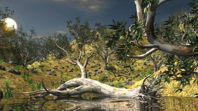

  • WendyLuvsCatzWendyLuvsCatz Posts: 41,646
    edited December 2016
    actually I am only half right
    if I save it with morphs injected in Poser as a pz3 and import with the skinning etc options checked the morphs do actually work and some of the maps load but need tiling, others need adding but it is useable just needs the shaders redone but you can use those maps in Carrara terrain shaders I did a quickie the cbr should find your maps if lucky.
    1920 x 1080 - 311K
    1920 x 1080 - 1M
    zip
    zip
    terradome test.zip
    10K

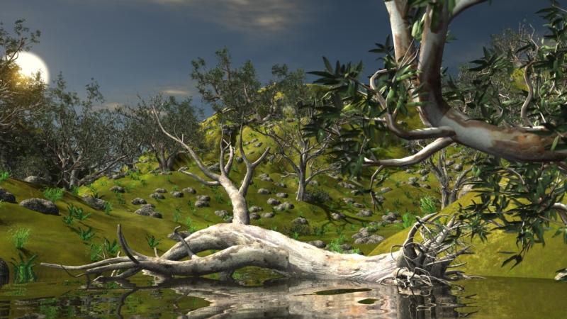

  • StezzaStezza Posts: 9,258
    Thanks Wendy for the tips.. a quickie to see yes
    same file with one of the TD2 textures applied
    800 x 450 - 329K
    800 x 450 - 363K
    Post edited by Stezza on

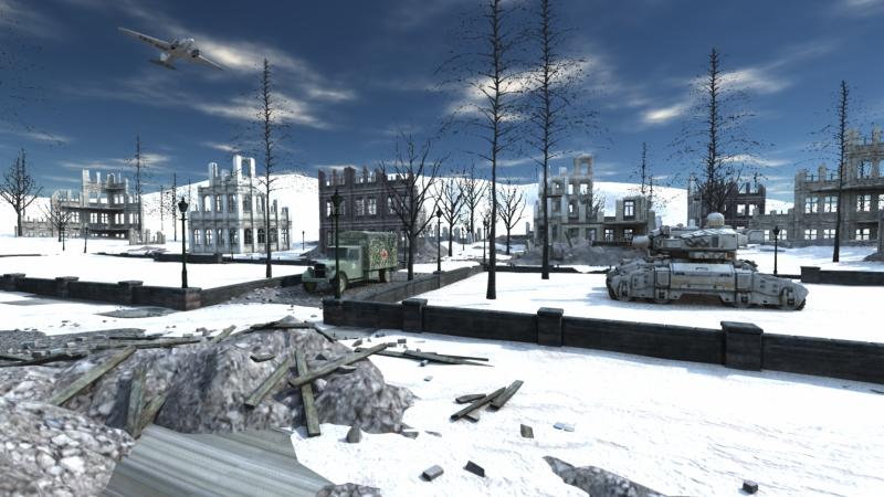

    another quickie using TD2 with Stonemason's after the war
    800 x 450 - 287K
