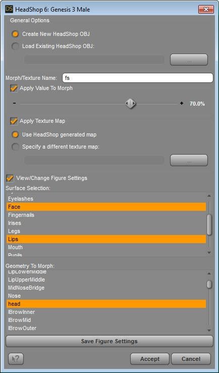

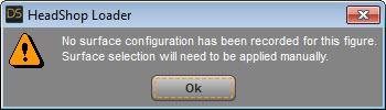

b. Select the figure in the scene tab and from the menu select Edit-Start Headshop. You’ll get a popup message saying “no surface configuration has been recorded”. Click OK. On the next dialog, choose Face and Lips in the Surface Selection box. In the Geometry to Morph box, choose Head.  The order differs between G2 and G3 figures but the choices are easy to find. I do not know what any of the other choices do. Also in this dialog, you can give the morph a name, the default is “fs”.

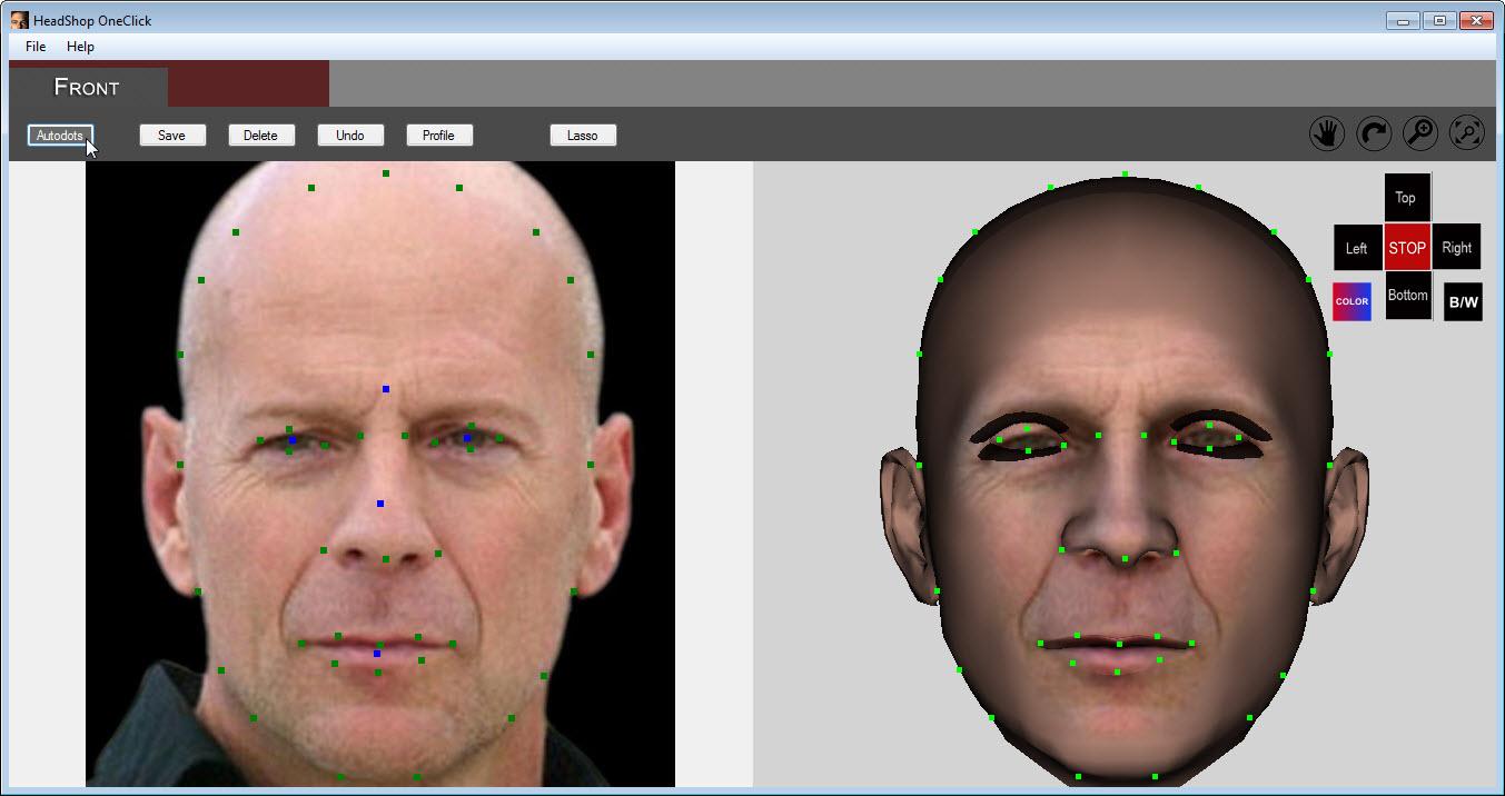

c. A new dialog box will open. Click on the big white space on the left and pick an image with a frontal view. For best results, it should be a dead-on front view. If the face is slightly angled, it seems OK but the farther offset it is (either facing up/down or right/left) you’ll introduce asymmetry into the results. I did my first testing with my own image but for this review I searched Google for front/side view portraits and one of the first was Bruce Willis, who will be familiar to many, so I worked with him.
d. The image will appear with automatically placed dots. I find this auto-detection works really well.  In the image above, note the upper green curve at the top of the head, short of the top. I’m not sure if that indicates the hairline or the top of the skull. Click on the button Apply to proceed to the next step.
e. A new dialog box will appear showing the image on the left and the morphed head on the right. Click on the Autodots button in the upper left and the dots will appear on both.
f. You will see 3 blue squares: one for the outer face structure, one for the nose and one for the mouth. You can click on any of these to edit the dot location. Move the cursor over the dot and when it turns into a hand, left-click and the green dots will become red. Hover over any of the red dots, hold down the left mouse button, and you can drag the group of red dots to a new location. If you click on a red dot, you will turn off all but that dot and can drag it to a new position. You’ll see the result on the morphed head at the right. Just to show you what happens, I dragged one dot way off to the side. Use the Undo button to go back if you make changes you don’t like or didn’t mean.
g. That’s it! On the menu, select File-Export and the plugin will close (don’t just click on the X box in the upper right – Headshop will close without exporting the figure.) You’ll return to Daz Studio with the modified morph added to the figure. There is just one morph labeled fs set at 70% (the default value in step b). All the changes are merged into this one morph and I have found changing it from 70% higher leads to distorted features so I leave it at the default value.

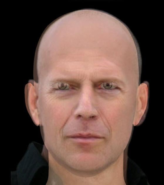

The results are shown below. One version has the image superimposed over the figure and the other has them side by side. I scaled the image so the eyes and lips are at the same level. There’s a family resemblance but not a match. I’ve consistently found the eyes, nose and mouth are in the right relationship but the ears are low and the top of the skull is too low. The eyes are too big and I also find the mouth is slightly open and the lips a bit fuller. Most of these can be manually adjusted but not all. For example, the teeth end up with rounded edges and small gaps between them and I don’t own any morphs to set them back to normal.
Remember the green line I mentioned in step d? That does appear to be the top of the skull. I redid all these steps, this time adjusting the green dots for the face outline so they enclose the entire skull. Now the result has a head whose size is a better match, the ears are at the right height, while the eyes and lips are only slightly too high. See image below.
h. The biggest drawback to Headshop is that the generated texture leaves a lot to be desired. The problem is that it grabs from the original photo an oval centered on the eyes, nose and mouth with a bit of forehead, cheeks, and chin. The rest is filled in a with a solid-tone skin color. The result is a mix of reality and an untextured solid color. Even though the photo has more of the forehead, skin and chin textures, they are stripped away. What are we to do with this? Anything other than a straight on view looks ridiculous. The author says you can hide the seams with hair but that’s unrealistic. Someone knowledgeable with Photoshop could probably make something out of this but I don’t have those skills. You’ll probably just want to use a character texture – that’s OK but takes it further away from a model of an actual person. It will also show that the model is less of a match than it first appears. See image below. I purposefully picked a younger-looking character skin to show how important the texture is to the result.
Another issue with using the plugin-generated texture is any facial hair around the mouth, glasses, makeup, shadows, etc. become part of the texture.  Not a problem if you can get a photo without any of that.

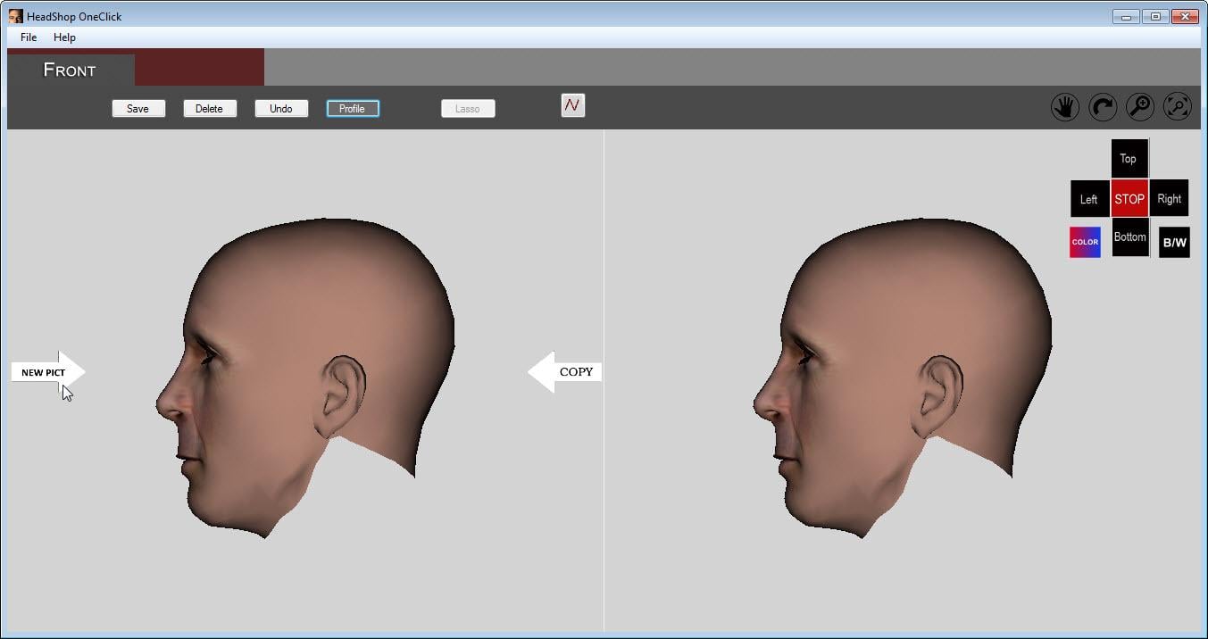

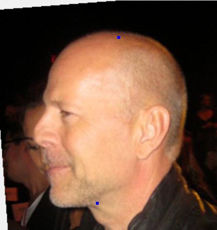

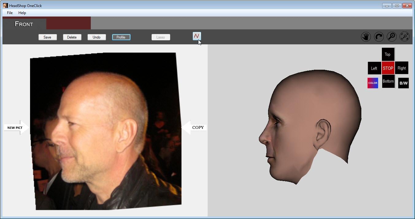

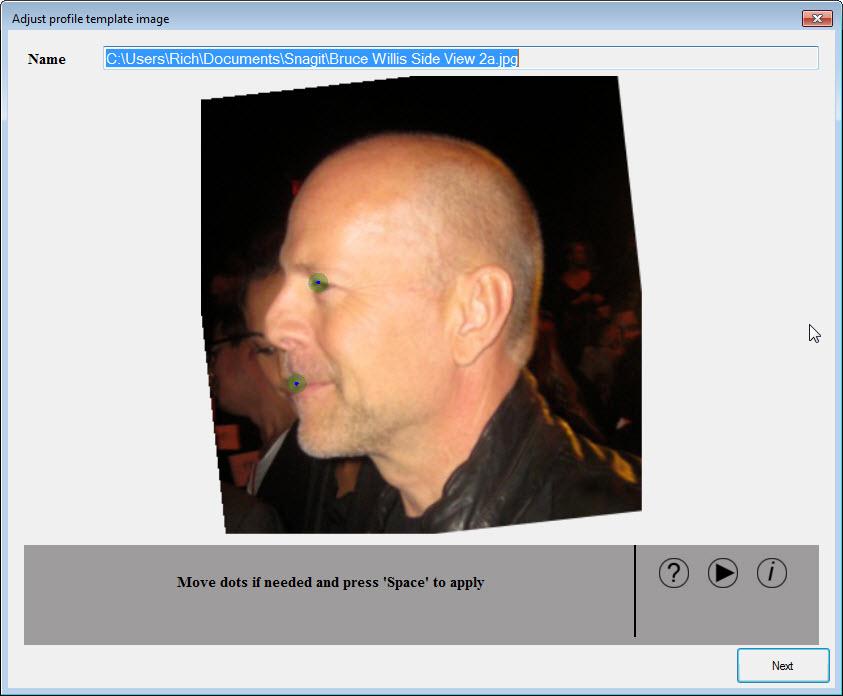

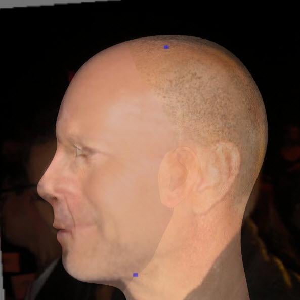

    4. I’ve found that although the front view looks similar to the person, the profile view usually doesn’t. You can modify the profile before you export by clicking on the Profile button.
    a. A new dialog opens with two profile heads. Click on the left New Image.
    b.  A dialog pops up where you can choose a photo. Again, this should be a dead-on side view but it seems to work OK if it’s only slightly turned or tilted.
    c. Your image will appear on the left. There will be two green dots you need to drag to the eye and the mouth. Click Apply and you will get a new dialog that zooms in on the face and lets you fine tune the placement of the two green dots.
    d. The next dialog shows that your image has replaced the left hand profile head. There will be two blue dots, one at the top of the head and one down by the chin. Click on the N inside a square icon at the top center of the screen. On your image, there will be two blue dots, one at the top of the head and one down by the chin. You will now see a partial red outline on the right profile head. You will want to outline this same area on the left profile head.
    e. To trace the profile of your photo, left-click near the top of the skull on the left head and a green dot will appear. Click further down the forehead and another dot appears. Keep going until you reach the chin area. There’s no guidance as to how many dots to use but I put them so I could capture transition curves, so for example, more at the tip of the nose than on the forehead. Note the modifed outline on the right head.
    f. When done, hit the ENTER key. Wait a few minutes and you’ll see the right head flash out to follow your new outline. What confuses me, is the right head shrinks back to its old look, so did the profile change take or not? Select File-Export on the menu to take the model to Daz Studio. When I look at the exported model, there’s some change but not as much as I would have expected.
    g. Here’s the profile image superimposed over the model. As you can see, the side view is much further off than the front view: eye and ears not as deep, chin not as defined, cheeks too shallow. This may be a result of the profile image being slightly turned but I got the exact same result using my own image. I also show the image and the model side by side and the model with the Eddie texture.

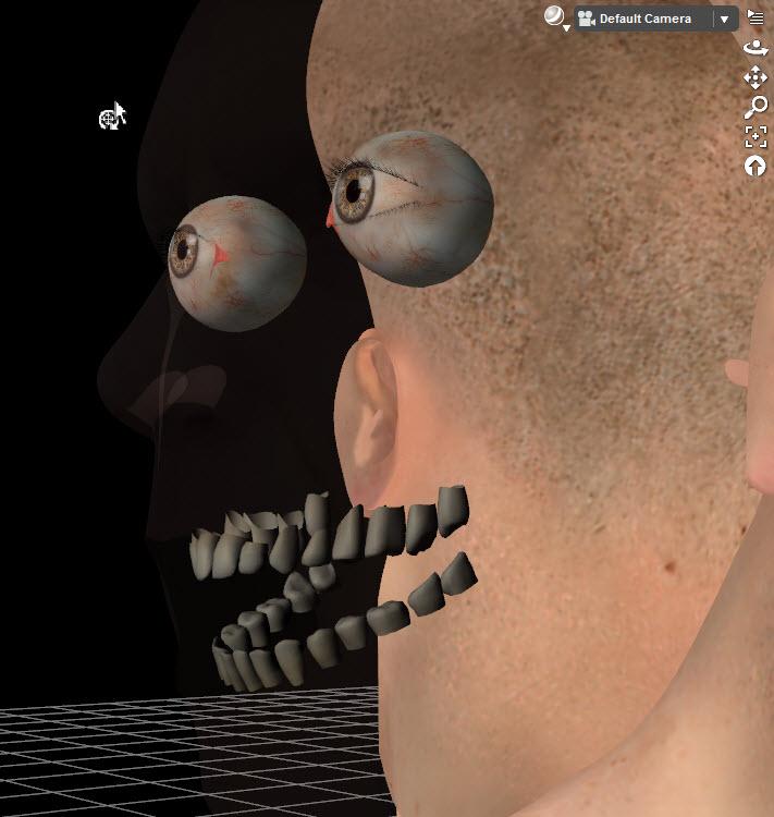

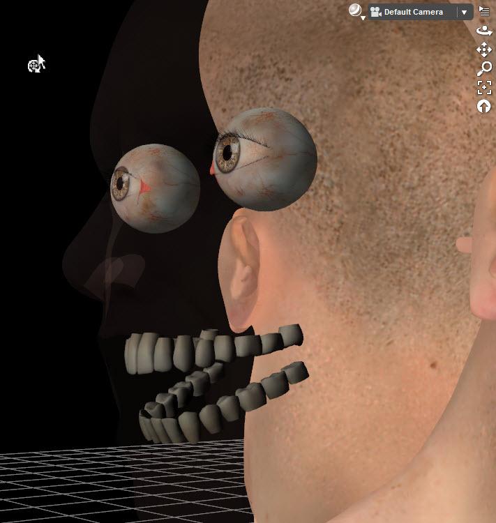

  • How well does HeadShop morph the eyes and teeth?
    Do the eyeballs retain their original shape, or are they warped?
    I would make the head invisible to get a better look.
  • RGcincyRGcincy Posts: 2,864
    edited December 2016
    Here you go. This is with just the front view modified, no profile changes. First image is G3 male base figure before HeadShop. Second image is afterwards. Eyes look fine but you can see the gaps in the teeth I mentioned. I don't have any teeth morphs to see if they can be adjusted back to original.
    711 x 750 - 76K
    711 x 750 - 75K
    Post edited by RGcincy on
