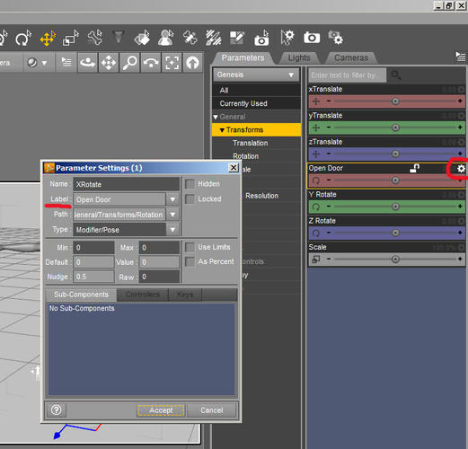

OK I have managed to move the pivot point and I can now open and shut the door, but I can't find anywhere that allows me to change the name of the rotation to Open/Shut.
Any help please.
Glad you have it done. You have to click on the little cog symbol, and go to Parameter Settings as shown below to change the name.
I see. Thanks Jimmy
You are very welcome Wnedy.
