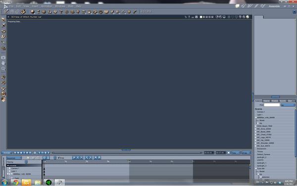

Well the loading bar finishes but I see preparing data in the upper left corner where the Camera is. I'll make a note of what you've said here. I hadn't made huge progress on the project but I'd made enough that I wanted to pick up where I left off. Thank you Holly, for the reply.

The scene loads and I do see the objects on the right side. However, in the upper left corner where it usually shows the camera name I'm currently using it says "Preparing Data..." and it never gets past that stage. I let it run overnight once and the next day it still said the same thing. :(
Can you click on anything in Carrara and get a reaction or is everything frozen?
Do any of these icons at the top of the Assembly Room window do anything (especially the circle with the up arrow)?
I went ahead and tried to reopen it. I can click on stuff including those icons. If I click on the up arrow I get the bottom part of an ok/cancel dialogue. Clicking on OK replaces "Preparing Data" with "Render failed." I've included screen shots.You can see the ok/cancel box at the bottom right above the animation toolbar.
Good news. I installed the 8.5 beta update and it opened in that. I'm not sure what the difference was. I opened it and resaved it. I set the scene view on Gourad and unchecked 'save preview' and 'compress file'.
I tested it and it still won't load in 8.1 but it does load in the 8.5 beta. I wonder if there is some bug fix affecting that?

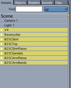

one last thing,.. How are you loading figures,...?
You have entries like "BlMillMan_etc...
If you're using the Carrara Content Browser to See, your Current DS or Poser stuff,. then you should see then loaded with their proper names EG: Michael 4,..Victoria 4 etc.

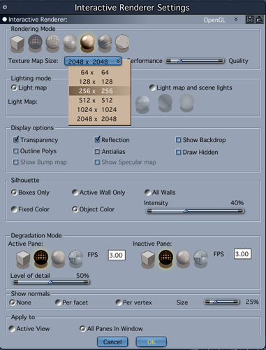

Oops! I meant to post some general tips on getting better Assembly Room and Carrara performance.

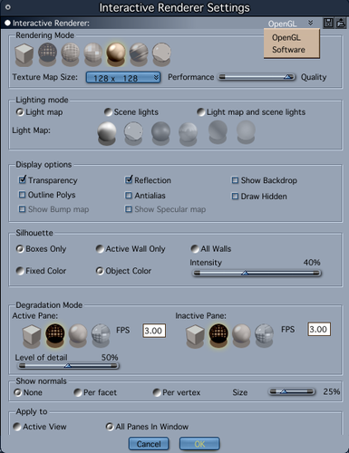

The Interactive Renderer (the up arrow within a circle) is very helpful. You can use software or OpenGL for the Assembly Room renderer. Unless you have driver issues with your graphics card, OpenGL would be the way to go. The Interactive Renderer has nothing to do with the Render Room. These settings are scene specific, so every scene you start you will have to set the renderer. Some people make and save a default scene with their preferred settings.
There are some settings you can tweak or turn off to ease the load on your card if it becomes an issue. The default texture size is pretty large, to speed things up, and reduce the overhead on your graphic card's memory, lower it's value. You can also turn off transparencies, etc.
To help with Carrara's memory handling, you can go to the file menu and open the preferences menu. From under the imaging and scratch disk section, try lowering the texture spooling. The initial value is based on how much RAM you have installed. The more RAM the higher the value. The slider defaults to about the halfway point. I have mine at around 70 MB. As far as I know there is no hard and fast rule, just that lower can be better. This is a global setting and will stay the same until you change it. You will also need to restart Carrara after making any changes.
This has been mentioned in many threads by many different people, but makes sure you clean out your temp. file. If you don't know the path, or want to change the location, you can refer back to the image and scratch disk section of the preferences.

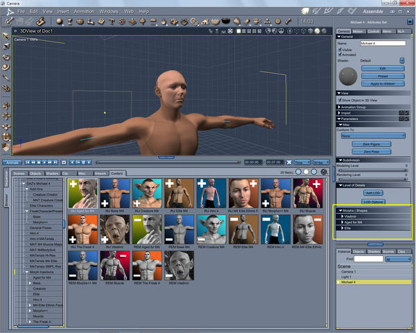

You would browse to the Poses section,. find the Morphs for your Figure,. and then Double click to inject (or remove) them See pic.
Once you've injected the morphs into a figure, you'll see a set of sliders where you can adjust the individual; settings,. just like you would on Poser or DS.

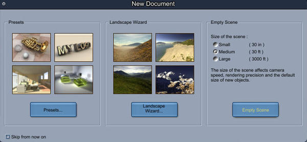

For the Default scene,... carrara has Three "Default" scenes,...
Small ,, Medium, and Large,. depending what you want to do.
