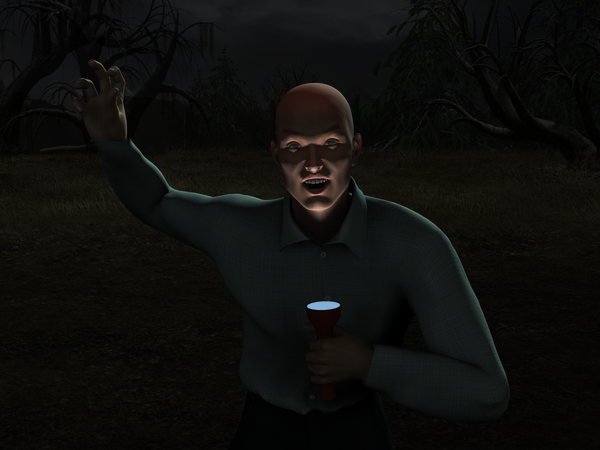

I think this is the effect you're looking for ?
In the surfaces tab, i used the ambient color and ambient strength of the flashlight's lens cap to make it light up.

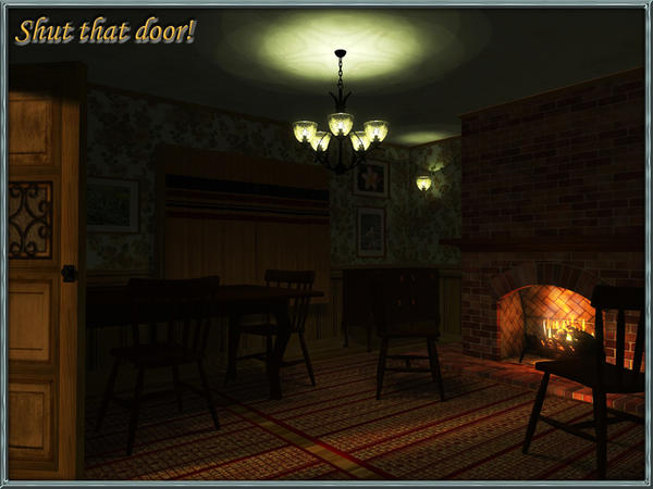

or like I did below was to use one point and two spots per light bulb and ambient on the light bulbs themselves.
The point light just sits on top of the light bulb, one spot above the point light, pointing upward and one spot under the light bulb glass facing downward,
I diid this for every light glass cowl in the image.
