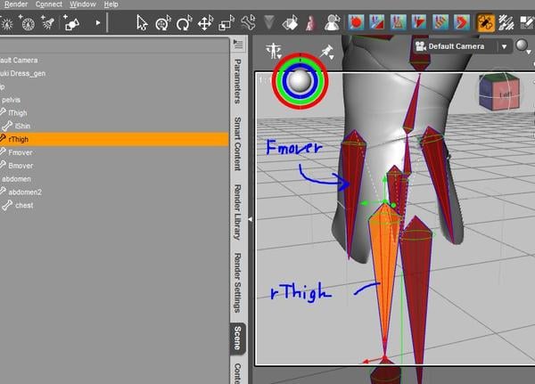

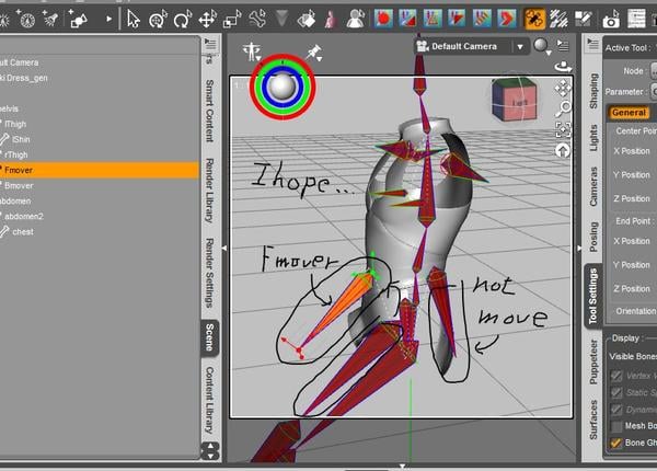

I hope to change rig of Karuki dress for genesis with some ghost bone.
now,, the " front roin" and "back roin" of the dress has been weight mapped to both thigh bone rotation.
it is useful usually,,,, but there seems some problem,,.
if right (or left) thigh bend forward,, as if there is magnet,, the back roin(skirt?) stick to the thin bones and move foward too,,
so I hope,, when one of thigh bend foward,,only the forward roin move foward too, but back roin do not move.
and when one of thighs bend back, the foward roin stay there,, only back roin to back with thigh rotation.
then,, I planned to set two child ghost bones (parented plevis) F-mover and B-mover ,for both roin,
and weight map for ghost bones bend (of course I know,, it remove weight map from things ).
now Front roin (vertices) rotate with F-mover, Back roin vertices rotate with B-mover.
next,, I need to ERC for thigh bones x rotation and ghost bones x rotation.

853 x 612 - 97K
811 x 582 - 71K

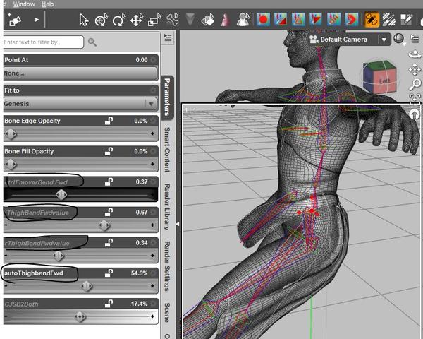

  • kitakoredazkitakoredaz Posts: 3,526
    now I made hide new parameters to keep each both thin rotation value,
    rThinvalue and lThinvalue,, it can only preserve negative(foward) rotation value,,
    then,, next make the property to keep delta of two,, rThinvalue - lThinvalue, as name
    RthinMinusLthinFwd,
    I set,, controller and sub components for each property to rotate my Fmover bone
    when genesis rotate her thins,,
    then it can work,, about all case 1 to case 3,,
    now my karuki dress can auto move its front roin,, when genesis rotate her things forward.
    then if I hope I can adjust it manually, by ghost F-mover,,
    (and I made controller to adjust the auto-follow value by multiple too,,)
    but,,,I am not happy,, :sick:because,, it is not simple and good way,,,,,
    if I know about dsf more,, , I can gather 4 controlloer to one, and no need to make
    new controller just for keep value and simple mathas hide parameter,,,, ,, @@;
    it may need just only one "followthinFwdmove.dsffile" in deta of the clothing,,,, I think,,,.
    so,,, is there good documents for dsf coding, with actuall case .
    I want to study dsf coding to set more complicate rig move,, ><; how can I do it,,, ??</p>
