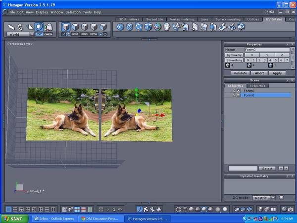

    Just trying to figure out what you guys mean by placing a texture on a single-thickness plane and not being able to see the reverse?
    This is a single poly, mapped and textured - the duplicate is flipped 180 degrees to see the back - no problem.
    Hexagon's UV mapper can do most of what Blender can, except mirror UV's. Even a sophisticated mapper like UU3D can't straighten out a multiple selection of edges without collapsing them into a single line - at least, I haven't found a method of doing so:)

  • SickleYieldSickleYield Posts: 7,652
    And it's is in Hexagon. DS/Poser are the issue here as they will not do that - with UberEnvironment lights on the backfacing will be black. Using a complex light set with a non-UE diffuse shadowcaster helps but doesn't eliminate the darkening of the backfacing side.
