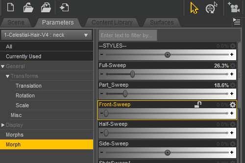

  • MedzinMedzin Posts: 337
    Did you inject the morphs from the pose file included with the MAT poses?
    1100 x 596 - 63K

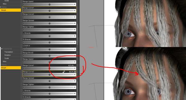

    There is not much effort to make screen capture.
    Standard keyboard has button saying "PrtScn".
    You press that once. Then open 2D image editor program that you prefer (Photoshop, PaintShop, whatever)
    Depending on program, you might have to create new empty file first, make dimensions about same as screen.
    Then paste contents of clipboard into file (usually a control V).
    Then crop picture down to size for showing concerned area and save as JPEG with high compression (makes small)
    When in forum, attach image in thread by browse to location where you save
    That is how I make this image that show parameter visible and operational when neck is selected
    500 x 333 - 19K
