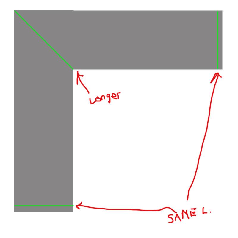

    Yeah - sweep path will not work for that because it tries to keep the profile the same size all along its length, but that corner needs to be longer than the straight edges (geometry for fun and profit! laugh).
    You will need to use your profile on one end, duplicate and rotate it at the other end, then put a longer duplicate of it in the corner rotated 45 degrees.  Once you've done that you can use Ruled Surface to connect them as @wgdjohn suggests above.
    That's supposed to say "SAME L." but I'm not at my "art" computer so I'm writing with a mouse again. laugh
