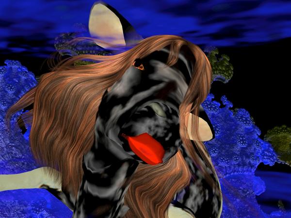

  • SockrateaseSockratease Posts: 813
    If you change the 2nd and 3rd letters of Carrara to an "o" and a "w" respectively - it becomes Cowrarra.
    That obviously makes it the best 3D Package of the lot.
    1600 x 1200 - 428K

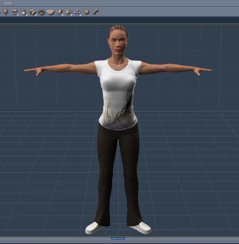

  • Kevin SandersonKevin Sanderson Posts: 1,643
    edited November 2012
    Moogaloonie, have you tried saving your Poser character as a .pz3? Carrara does a pretty good job of importing those in. There are some V4 characters who will not load properly in Carrara (I believe it may be an INJ code issue) but if you load them in Poser, save out as a .pz3 and import them into Carrara they load and look fine... in fact you don't have to tweak color, but of course you will have to make other adjustments like shininess. I just tried Alyson Casual to try a Poser figure, (in fact Andy is the only other Poser character I've saved as a .pz3) and imported her into Carrara and she came in fine with her outfit. I hadn't made any adjustments so I can't speak to poke through other than there was none in her outfit. Using Poser 8 and Carrara 8.11.12
    851 x 869 - 59K

  • Milo_471560Milo_471560 Posts: 511
    Also if it is a INJ issue then try using Fenrics utility that fixes those. I found a few that came in not well that it straightened them up.
