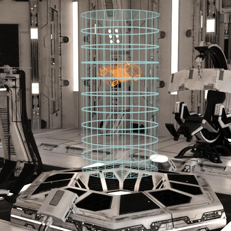

  • TabascoJackTabascoJack Posts: 865
    edited September 2016
    You could try making a monochrome crosshatch pattern in Photoshop or FilterForge, and then use that as an opacity map.
    Create a cylinder for the hologram tank, make it emissive, and apply the opacity map.   Do the same for the object in the hologram tank.
    I've got a render of this baking right now, I'll post it when done.
    Render attached.  If I were to spend more time on this, I'd probably delete the top and bottom of the cylinder, and add some blur and a little bit of noise to the opacity map to make it less stark.
    Attached also is the seamless texture for the opacity map.
    800 x 800 - 566K
    600 x 600 - 35K
    Post edited by TabascoJack on
  • Canary3dCanary3d Posts: 2,033
    I haven't done this in Iray but I did it ages ago in Poser - do what TabascoJack suggests to make a transparency map, but instead of a grid, use the object's texture template. That way it shows the actual wireframe of the object.
    Ooohh....that's a great idea!
    My example was an imported object that didn't have a template, but if it had one, I would definitely use it.
