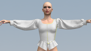

I've made a top for Genesis (see below) and now need to start weight mapping. This needs to be able to cope with loose fits for the sleeves and lower 'frill'.
Are there any good introductions that deal with this?

    Often when creators want loose fits they make the model skin-tight and then load the desired shape as a morph, locked to 100%. That would probably make the weight mapping easier. Have you applied the Transfer utility to the existing shape? If so, where does it fail to give good results?
  • BagletBaglet Posts: 0
    No I haven't even imported the obj so far. I'm not sure where to start as it is all new for me. I've only ever made conforming and draped clothing before. So I don't know what can and can't be done.
    The image is from Marvellous Designer which I used to make the item. I'm not sure their exported objs would morph well as it does not output the quads that are used in regular clothing.

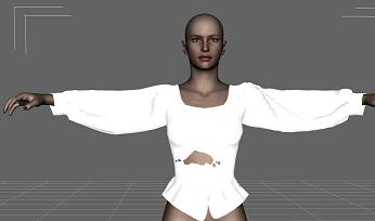

    It sort of fits but not around the Abdomen2 area.

    If you modelled around Genesis female did you choose that as the source shape when running the Transfer Utility? Or if Genesis is already morphed, you can choose Current as the source shape (which is useful when working with multiply-morphed mannequins). Also, you need to bear in mind that if you model around a morphed figure then by the time you've reversed the source shape and then DS has auto-generated a morph you have a double approximation - you may find it helps, at least for single morph, to load your model as a morph for the rigged clothing in place of the auto-morph.

    I modelled it around the Genesis female shape but choosing Current or not made no difference. What has helped is adding a little smoothing - 3 iterations.
  • Richard HaseltineRichard Haseltine Posts: 112,275
    Go to Morph Loader Pro (Edit>Figure>Morph Loader Pro...), pick the same preset you used for loading the clothes at the top, click Choose Morph Files and select your original OBJ, then click the triangle next to the OBJ name to expand the options: click the name to get it editable and enter "FBMBasicFemale" so that it replaces the auto-generated morph, right-click the current setting for Property group and pick or create the right group for the morph (Actor/Real World/Female), right-click on the current option for makeUnique and choose deltas only (so it overwrites).

    Nice top Baglet...sometimes smoothing is the way to go! The other option is when using the transfer utility to choose Item shape as Current and then click on show options and make sure you select Reverse source shape from target. Other settings can remain the same as you've used previously. I would try reverse source shape first and if that doesn't fix use the smoothing options.
