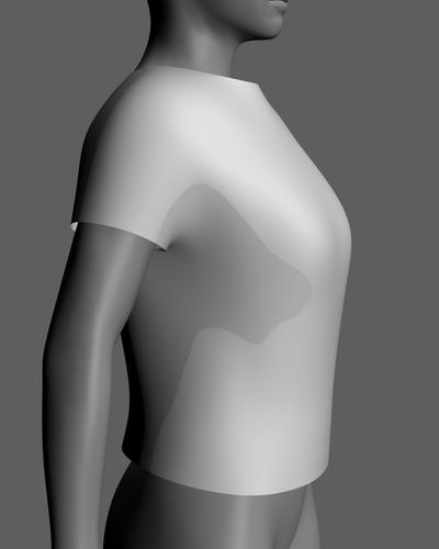

    Now, here's an item I made, earlier tonight...as an experiment. This is the top part of the duf file. I don't have any textures for it so there aren't any entries for them. The bold line is the geometry...

    I suppose that it would be possible for the 'user' to just export the obj...but I like to include it in the zip anyway. Yeah, it's kind of redundant..,to me, it's 'complete'.
    1024 x 1280 - 207K
