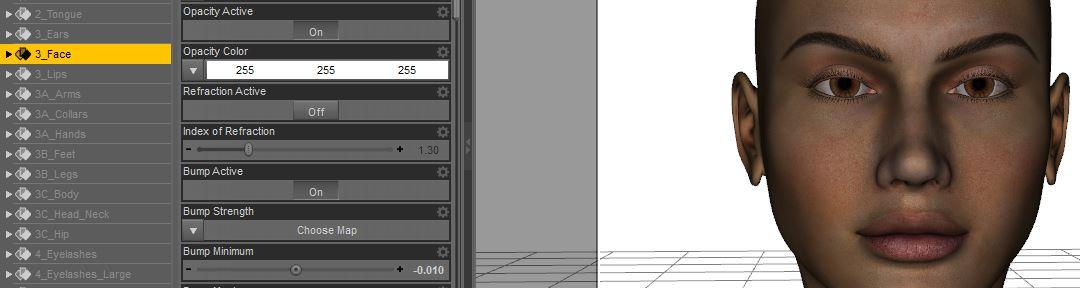

    Can you look at Face material under surfaces tab and tell me what channel map has the Brow Details on?

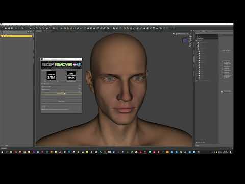

    I'm running macOS Catalina 10.15.4, while I'm able to get everything to work, when I restart Daz and return to my model, it is unable to find several files, despite me saving it as a material preset. The files it mentions are:
    runtime/textures/daz/characters/genesis8/malebase/g8mbasefacemapb01_1001_dszvbrowremover.jpg
    runtime/textures/daz/characters/genesis8/malebase/g8mbasefacemapd01_1001_dszvbrowremover.jpg
    runtime/textures/daz/characters/genesis8/malebase/g8mbasefacemaps01_1001_dszvbrowremover.jpg
    runtime/textures/daz/characters/genesis8/malebase/g8mbasefacemapsss_1001_dszvbrowremover.jpg
    This will happen with /femalebase/ as well. I'm attaching a video to show everything I'm doing. Am I doing something wrong? I've tried restarting, uninstalling, reinstalling, but other than that, I don't really know what to do. If I navigate to the above folder, I am able to remap the files, because they still exist, but its a hassle to do it every single time.
    I uploaded a video of my entire process to show what I'm doing.
    https://www.youtube.com/watch?v=OxcccLfn930
  • Zev0Zev0 Posts: 7,123
    edited June 2020
    Change the path for New Browless textures to a none cloud folder and tell me if that works. Eg outside of connect.
    Post edited by Zev0 on
  • airunairun Posts: 28
    Perfect! That worked. Thanks for the quick reply. I actually did not even notice that New Browless path above was capable of being modified. Keep making great stuff.

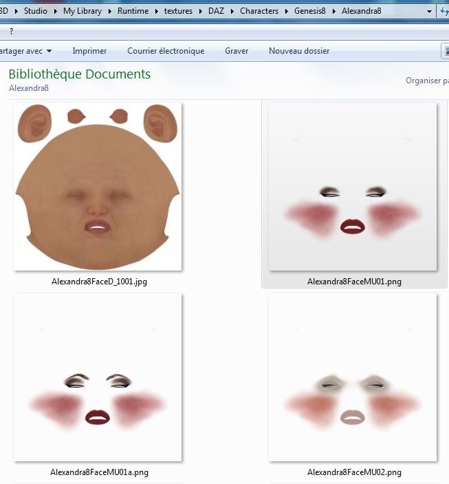

  • Hi Zev0,
    Thanks for still providing support. It's pretty rare and deserve a round of applaudes.
    I was very happy to discover your Remover as I use tan on my characters, which makes the brows going unnaturally too dark.
    I do this
    1- G8F Character selected
    2- Open Remover script > Select G3F > Show Mask
    At this stage the whole face is white already
    3-- Apply Remover : brows are remove but the face is still Joker type
    5-Saving using the Remover.
    6- Checking the runtime folder  : yellowed "brow removed " seems identical to initial :-(
    7- Selecting Material present file "name_Nobrows", loading it...
    8-  Result : white face with brows..
    I understand there is something I'm doing stupidely wrong...any help would be welcomed !
    This is the result I'm having : a pale jokertype face :-)
    What am I doing wrong ??00
