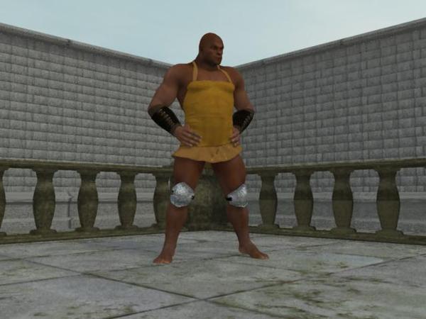

  • 3DAGE3DAGE Posts: 3,321
    edited October 2012
    If you model and use the base genesis then the figure Scale will be correct for genesis rigging "Bones transfer"
    Once that's done,. the outfit will Auto-fit to the figure,. and any morphs you dial in will adjust the outfit to fit that figure ...
    whether it's male or female.
    Generally clothing should be made to fit the base mesh of the model. not a customised shape.
    Hope that makes sense :)
    quick example :
    Ben (M5) is modelling the scoop back mini-dress which fit's him perfectly while allowing him the freedom to show off his combat skills :)
    640 x 480 - 37K

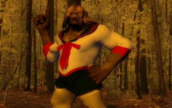

    awsome render , i mean ... funny !
    ever you tryed ogre genesis with hongju's schoolgirl dress ? XD
    anyway i'm ok with what you say , i mean i know that , but ...
    scoopback mini is not the dress i made , plus you are showing a female dress on a male figure , ok , but try to show a male dress on a female figure , you'll get the shirt or anything is on the chest part to follow exactly the breasts shape , it's unnatural , unless the shirt is very tight .
    if instead i can model the dress around a morphed figure i can correct the gaps during the modelling phase and make a dress which is actually made exactly for that character , this also prevent the stretch between tights , the gap between glutes and i can keep my polycount relatively low , because i would need to increase the number on breasts and glutes themselves or i will see the skin popping out from the polygon surfaces of the dress in those areas
    ultima9999
