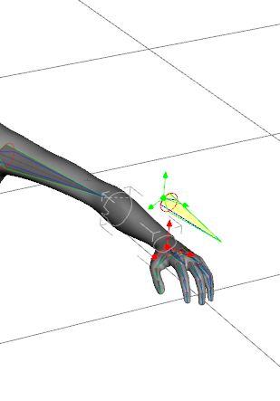

  • Richard HaseltineRichard Haseltine Posts: 111,250
    I applied the Faerie morph to Genesis, then I used the Joint Editor tool to move the lForearm out of place (which would be a bloody silly thing to do for real, but it serves as an illustration). I'd also moved and rotated the Genesis figure, but it was otherwise zeroed. Having selected the figure and the morph (FBFaerie) in the top lists, I then unchecked the translations and rotations that I didn't want to link and left the axis Origin values (the moved joint centres) for the lForearm checked.
    373 x 697 - 49K
    309 x 443 - 20K
  • RKane_1RKane_1 Posts: 3,039
    That illustrates it pretty well, thanks! :)
    How do I know when I need to NOT include an ERC? Like when the morph is all upper torso and ERC Freeze wants to include a foot, or something?
    By inspection - if it's offering to include something that you don't think should be there (such as a foot setting on an upper-torso morph) then Cancel and look to see what is going on with the figure - it may indicate that the figure has other morphs applied, or is posed, or that something went wrong with the morph creation.
