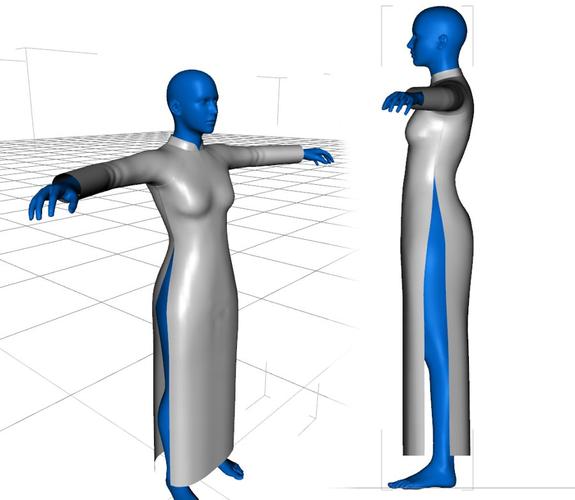

Vietnamese national costume.
This is a long dress, with a pair of wide pants. And a hat.
I am modeling the hat to fit to the "Pure Hair: Retro" : http://www.daz3d.com/shop/pure-hair-retro
According to my consultant (that actually use to wear this dress) this hair is approved to this hat.
So I have some questions....
How many bones should there be in the skirt ? I was thinking 6-8. This dress is made of silk, so it should be very movable.
The hat. Should it be fitted to Genesis or to the hair.
I'm still working on the pants. They are made of silk.. so there are some folds in them.... And they are wide. First time I saw them I thought they were a skirt....:red:

  • OdaaOdaa Posts: 1,548
    Wow, very cool!
  • LeanaLeana Posts: 11,059
    That looks awesome :)
    I'd say the hat should either be a smart prop or fitted to genesis and not the hair.
  • bytescapesbytescapes Posts: 1,810
    Agreed. You might also consider making a nón lá ('leaf hat', the classic Asian conical hat), which would go well with the aoi dai.
  • SickleYieldSickleYield Posts: 7,629
    I politely disagree. Fitting a hat to the head and not the hair will often cause hair clipping with any FBM. I sell a product to fix that, so I certainly don't mind if people want to do it the other way. ;)
    I suggest the skirt is fine with the usual four bones (upper and lower right and left) and that with a few morphs you can make it move like cloth much more easily than with more bones. Are you modeling this against a single female morph or against base Genesis?
    It's a great-looking set, either way. I love this look and I will look forward to seeing it finished.

    While I was waiting for the update on CorelDraw, I was working on making fbm morphs for the hat when I discovered an interesting challenge.....
    Creating fbm's for the different bodyshapes (like M4,M4,Basic female,45,v4 etc....) is no problem.
    But if you apply a different face shape, or adjustment, they will also morph the hat. And taking into account all the current and future variations, I had to have a look into smartpropping...
    With the latest Studio you can now create smartprops, something that wasn't possible before..
    I did find out that when applying a different bodyshape, (V5) the hat did scale and move down with the head. But since the V5 head also moves to the front, the hat needed a slight morph adjustment to the front....
    And with the Hex-bridge, adjustment morphs are easy to make....
    (the only stupid thing that I have discovered is that those morphs doesn't work in Carrara)
    800 x 460 - 108K
