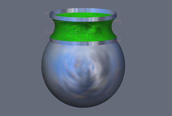

    Chancellor RedSquare, I've included a pic, just to satisfy your curiosity. I think you'll agree, it is an earth-shattering piece, the creation of which will carry far-reaching and cataclysmic implications for the political stabilty of modern civilization.
