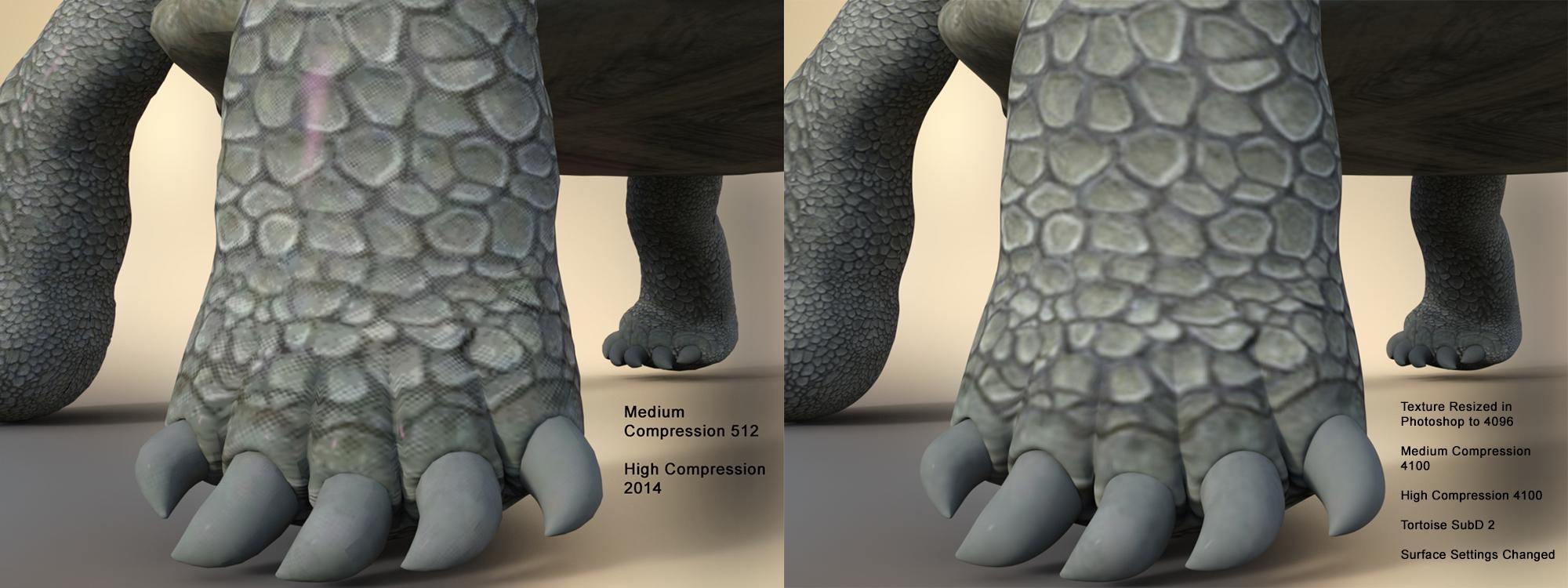

    Have you examined the texture file in an application like Photoshop, to see if the problem is in the texture itself? Maybe you only see it in the foreground, because you are much closer to it there. The back leg is further away and so a low res texture would not be as visible.
    It could possibly be a texture compression issue. In your Render Settings>Advanced tab, double the values for medium and high compression, and see if anything changes.
    What item/texture is this? If I have it, I'll take a look, too.
  • Thanks for the info, much appreciated. I doubled it like you said and it did help, I even tested a triple, but I can still see the issue, but not as bad. The texture is off of the Galapagos tortoise and it is a 2k map. Thank you again for your comments

    I have that tortoise. It is a really old Poser model. The texture seems to perform very poorly with texture compression, when you try to render it with that close view. The poser material settings do not work well in Iray, either; it has a pinkish specular color and uses displacement maps and settings that are not appropriate for Iray.
    I improved the appearance by doing all these things. Each one contributed a little bit to the fix:
    1. Resized the texture maps in Photoshop to 4096 by 4096.
    2. Changed Medium and High Compression to 4100 to prevent compression.
    3. Converted the Tortoise to SubD and set Render Subdivision to 2
    4. Converted the Surfaces to Iray Uber shader, substituted Base Color maps with my resized ones, deleted the Displacement maps, increased Glossy roughness, changed Glossy Color to light gray.
