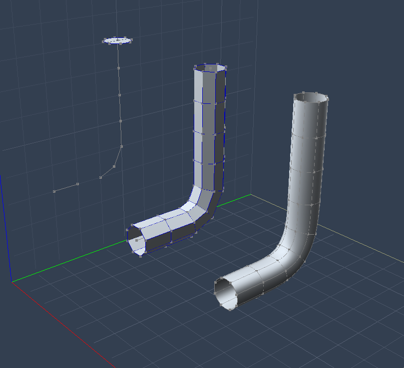

Is there a way to have more than one line in the sweep path in the spline modeler?  Say I wanted to make a length of pipe with a 90 degree stub pipe.  The closest I can come to that is by making a 90 degree turn from the main straight, go up a distance and set a point, move over like .005" and set a point, and then come back down to the main straight section to set a point there before I go further with the main section.  The drawback to this is that I do not get a flat end on the extension.  I have not yet figured out vertex modeling.  It probably could be done there with better results.
    I think that your best bet will be the vertex room, you need to create the path on one of the grids, in this case I did use a left side, then placed an octagon on the top of the path, used the path sweep tool, then the resulted polymesh was smoothed on the edges and SubD to 3:

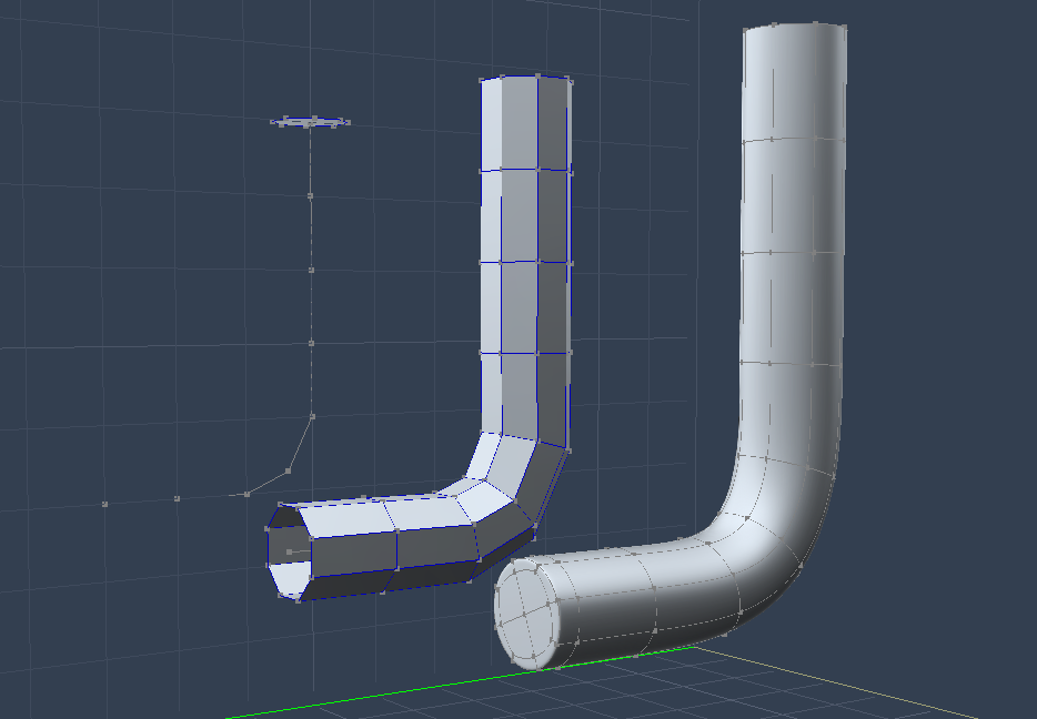

    I can do a single bend or turn in the spline modeler.  It looks like what you show here.  But basically what I was seeking was to be able to make a "T" pipe or a series of "T" extensions along a sweep path.

  • otodomusotodomus Posts: 332
    I've just talked about a "T" tube in the thread I started, I think you may try the vertex modeller room, I am talking about how good is and even compared with other popular software, this is the sample I did:
    If you do this basic shape then you can get the one that showed in your post. What I am doing is shapes with an octagon shape that at the time is Subdivided to 3 it turns into rounded shapes, this is how the above model was done, with many advantages as a low-poly and easy to UV map.

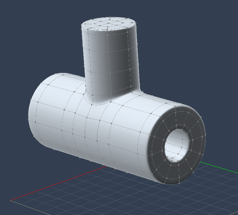

    This is a T tube with both parts with same size.
    First start with two octagon shapes aligned this way, and add the necessary loops as is shown in this left side view:
    The bellow octagon needed at least two extra loops and I have aligned.
    Select the face in the botton of the upper shape and clear it, (empty polygon)
    Link the vertex points that are aligned to the above shape:
    Select the area did result and again, empty the polygons:
    The next step is to try to aproximate the aligned vertex in both shapes, move the ones in the upper shape:
    Select the two nearest vertex and choose weld option:
    This is how you will see your T shaped tube, now select the entire geometry and smooth it.
    You will need an extra loop moved to up the above figure to do a smoother joint:
    Select the geometry and subdivide by 3:

  • TimBoTimBo Posts: 151
    otodomus said:
    Will follow with a step by step process.
    Thanks for the guide.  It took me a few tries to get it but I eventually got it to work.  I have lots of questions about vertex modeling but maybe I can figure out most of them myself.  I have become so accustomed to the spline modeler but I see now where the vertex modeler can do a lot more once I figure it out.
