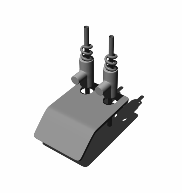

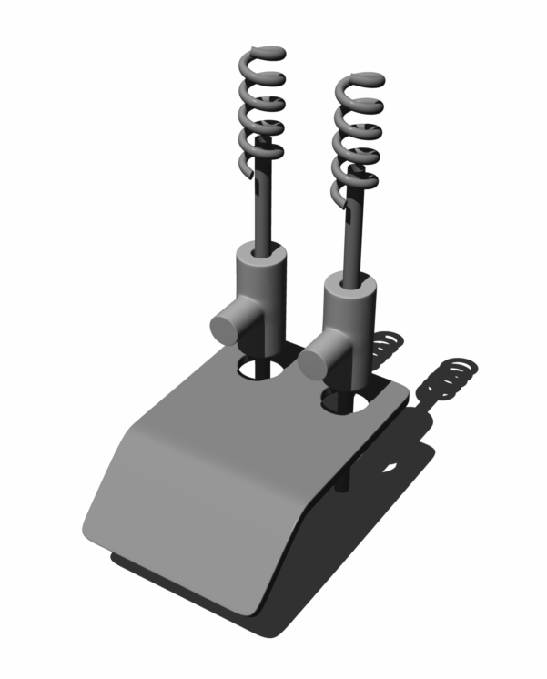

    Thanks Roygee, I am starting to model each part as a separated vertex object, which is nice is to see how accurate would be the alignment process in Carrara, all the parameters are well defined, I did the following just as a test of how could be the process:
    I did duplicate some parts, and I have a question: There's a way to parent those duplicated parts that makes that if modify one the other one makes also the change?
    Regards

    Thanks Varsel, I have choosed one of the springs in the previous model, and edited the Master ( I did the spring longer) and the other one did the change aswell. Cool!

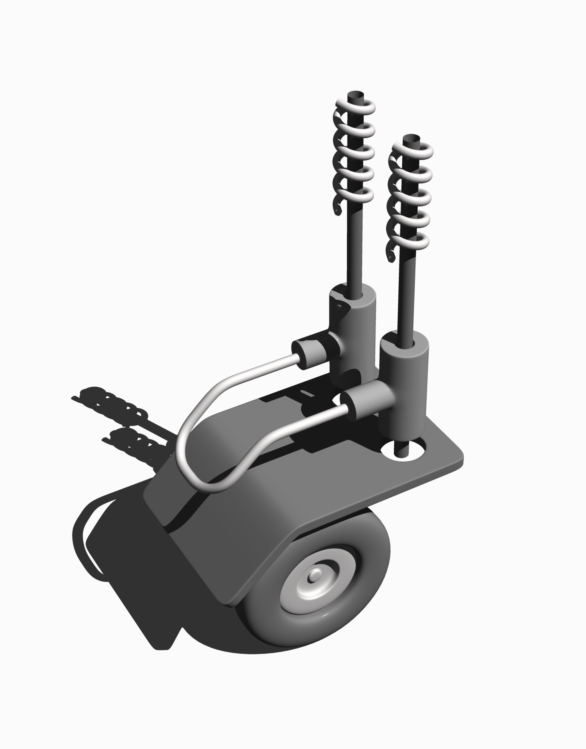

    The other question I had in mind was: what if I need a base part that needs to have the same angle as in the flat piece? What I did is went to the vertex room, selected a segment at the bottom, duplicate it and copy paste in other vertex object> modelled there and here it is: a very accurated part that fits perfectly with the angle of the previous part.
    So excited as is my first time modelling a multi-part model in the vertex room laugh
    Post edited by otodomus on

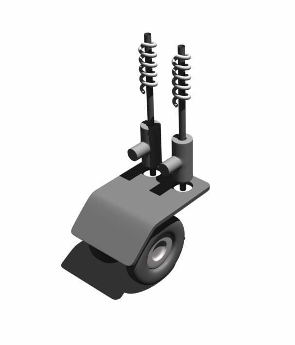

  • otodomusotodomus Posts: 332
    Ok and i did the inner ring by duplicating the wheel, created a new Master and edited to get the inner ring just in the place it needed to be:
    And of course as is other object can be shaded with other texture.

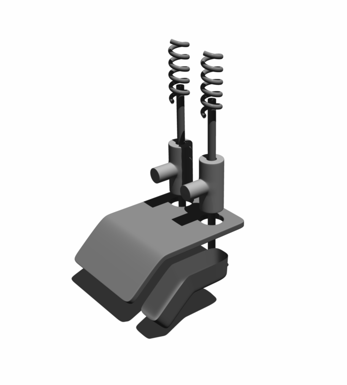

    I am just messing around, exploring what I can do, this is the progress so far:
