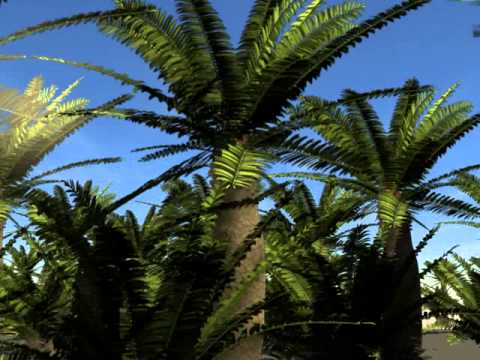

    It was only fairly recently when I've found out what a Splat is. A Splat is an object that is exactly like the "Facing Camera" particle, except that it's not a particle. Still haven't used one, but I'm glad to know their there. When I bought the X-Frogs billboards for a few sets of tree-types, I wish I'd have known about splats. I used single polygon (4 vertices) planes to create my billboards. So I actually used two billboards per tree - both the same thing set 90 degrees from another - forming an 'x' if viewed from above, so that I could replicate them all over the place. With Splats, they're always facing the camera, so there's no need for the extra plane! Ooops... am I babbling again? I'm babbling again!

    Sorry to say, but the splat is seriously bad to work with - it is invisible in the viewport and has its pivot point up on the top right corner, so very difficult to place accurately.  Better off using a plane facing camera.
    Their transparency does strange things when there are other transmapped items behind.
    The first pick is splats and the second planes.
    I'm pleasantly surprised at how well a camera fly-by worked - thoght it would be weird, with the trees rotating to face camera, but not at all :)
    640 x 480 - 252K
    640 x 480 - 306K
