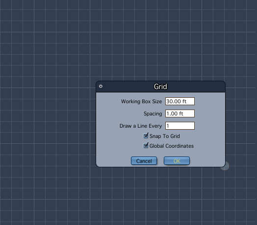

Hello friends a dumb question here, I want to work in cms or meters in vertex room, and I want to set up my grid based on those units metrical system, but I can't find how to do it, and I can't find neither a relate topic in serach function, anyone can help me out?

    Hi Otto
    you must change the default settings in "preferences" from inch to metric smiley
    960 x 600 - 205K
    Post edited by pimpy on
    OR, for a temporary change, select the SCENE in your Instances thab, then go to Interfaces, & Displayed Units in the properties window. This will set the units for the current session.
    373 x 896 - 211K

    Thank you Tango Alpha and pimpy for your quick responses, yes
  • otodomusotodomus Posts: 332
    It was easy, and believe me, I have years working with Carrara and its the first time I needed to change the units setup and I had no idea how to do it cool
