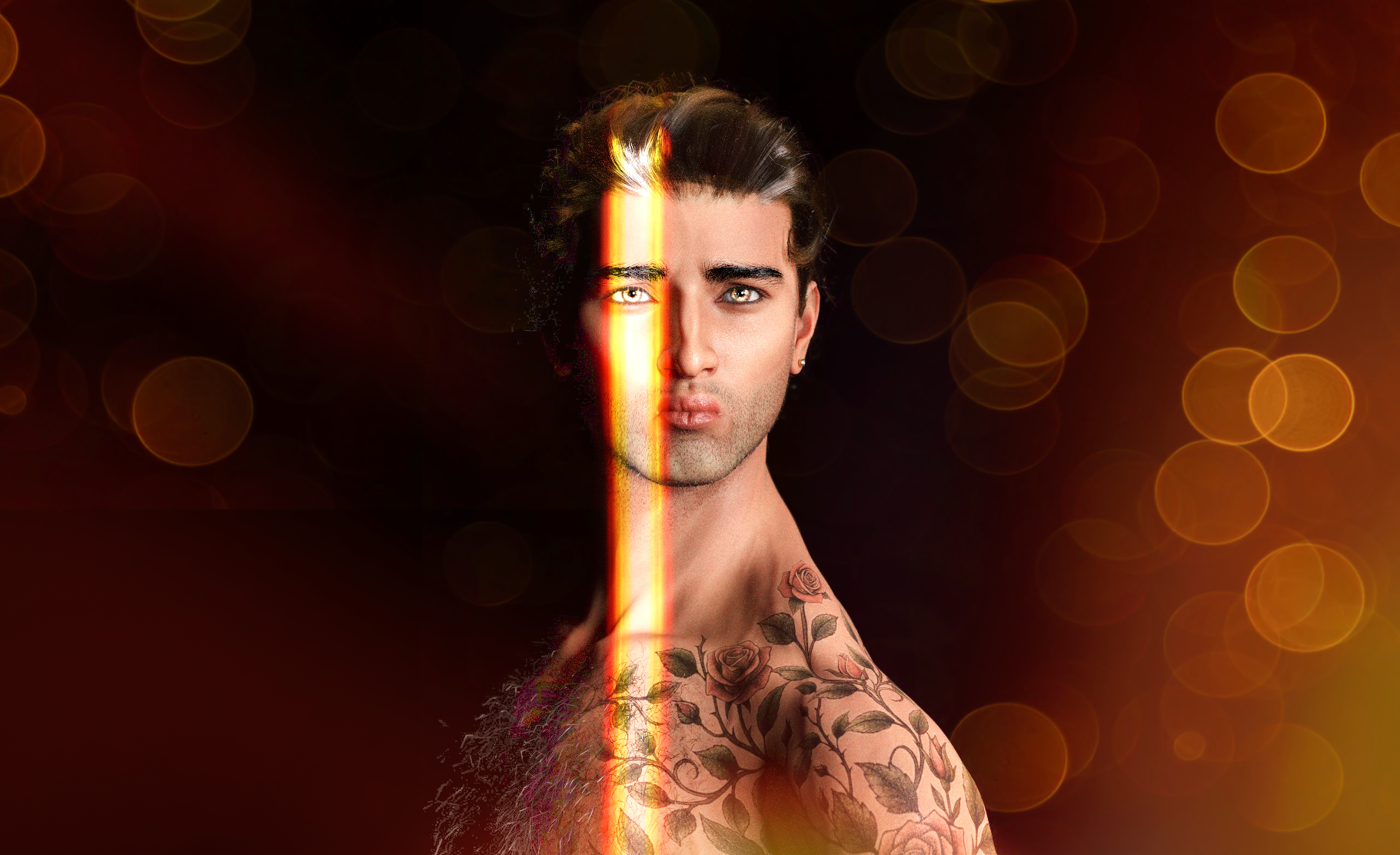

    You can look in the Surfaces tab to see if eye moisture is used.  One thing I highly recommend is to use a good HDRI so that there is something for multlple light sources to enter the eye.  I recently did a render with ChangelingChick's Caius and had light entering the eyes from several sources. As always, click on the image to expand.
