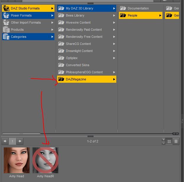

    You'd probably want to unzip your folder first, but with WINZIP compressed folders, you can drag and drop the files directly into the target folder, and it decompresses them automatically. Since you are using Winrar-compressed folders, you will need a program that is able to decompress Winrar to decompress the files first, otherwise you can't install.
    First, you go into the ZIP-Folder of the freebie. In some folders, it starts directly with Runtime, etc as a subdirectory, but here I have a "content" overhead folder. You can not use the "content" folder, but you need to copy the folders inside the content folder to your designated freebie library.
    Second, Mark all the folders in "content", then right-click and "copy".
    Third, go to the folder where you want to install the files. I created a library for my freebies only, so I can install and deinstall them easily, and they do not get mixed up with my paid content. But most users copy the files into their regular library. There are some rare morphs/items that have to be integrated into the regular library or they won't work. The process for copying is the same for both cases, just the target directories are different. If you are installing your new content into your DAZ-Library, you will have to go to "My DAZ 3D Library", or however you have named the folder. The folder already contains subdirectories with the same name as the folders you want ti paste into it, but that is fine. We are now going to merge the new folders with the old folders.
    Inside the library-content top level folder (where you can see all the "data, People, Runtime" folders) Right-click again and select "paste". The dialogue will now open and ask you if you want to merge the new folder with the existing folder/s ("Runtime", for example). Click "Yes. There are usually several "conflicting" folders, so you either have to repeat the merge for each, or you check off "use method on all other conflicts" (sorry, I don't know how the option is called in the English language version, but it should have a similar meaning). The content will now be copied into your library directory. In case you get any other error messages about "readme" files being overwritten, don't panic. If it's readme or license files, it usually can be overwritten, with other files, check out carefully what will be overwritten. If in doubt, cancel the process and check back with the ReadMe or vendor if it's okay that the file gets overwritten by the new file.
    Fourth, it's time to tell DAZ Studio about the new content folder. (This step is only neccessary if you are using a new, unmapped folder for content. Skip this step if you are using the regular content folder, or the folder was mapped already.)
    Open DAZ Studio. In "Edit", go to "Preferences". In the "Preferences" window, select the "Content Library" folder. Click on "Content Directory Manager". A new windw will open. In "Content Sets"-->"Current Directories" select the "DAZ Studio File Format" directories. On the left hand menu listing, under "Directory", click "Add". Now you can select the folder where you have your new content. In my case, the folder I add is "Downloaded Content/DAZ Magazine". I then repeat the same step for the "Poser Formats" directories. This is important, as most content has DAZ&Poser format files, so it will not work/you get error messages if you just install your new folder in the DAZ Studio File format. Click "Accept". The window will close. In the "Content Directory Manager" Window, click "Apply", and then "Accept". Again, you do not have to do this if your folder is already known to DAZ Studio.
    Fifth, your new content folder is ready for use now. If you are using the regular DAZ content directory, you will find the content there, just like regular content you installed. Be aware, though, that content not installed through DIM is not marked as "New".
