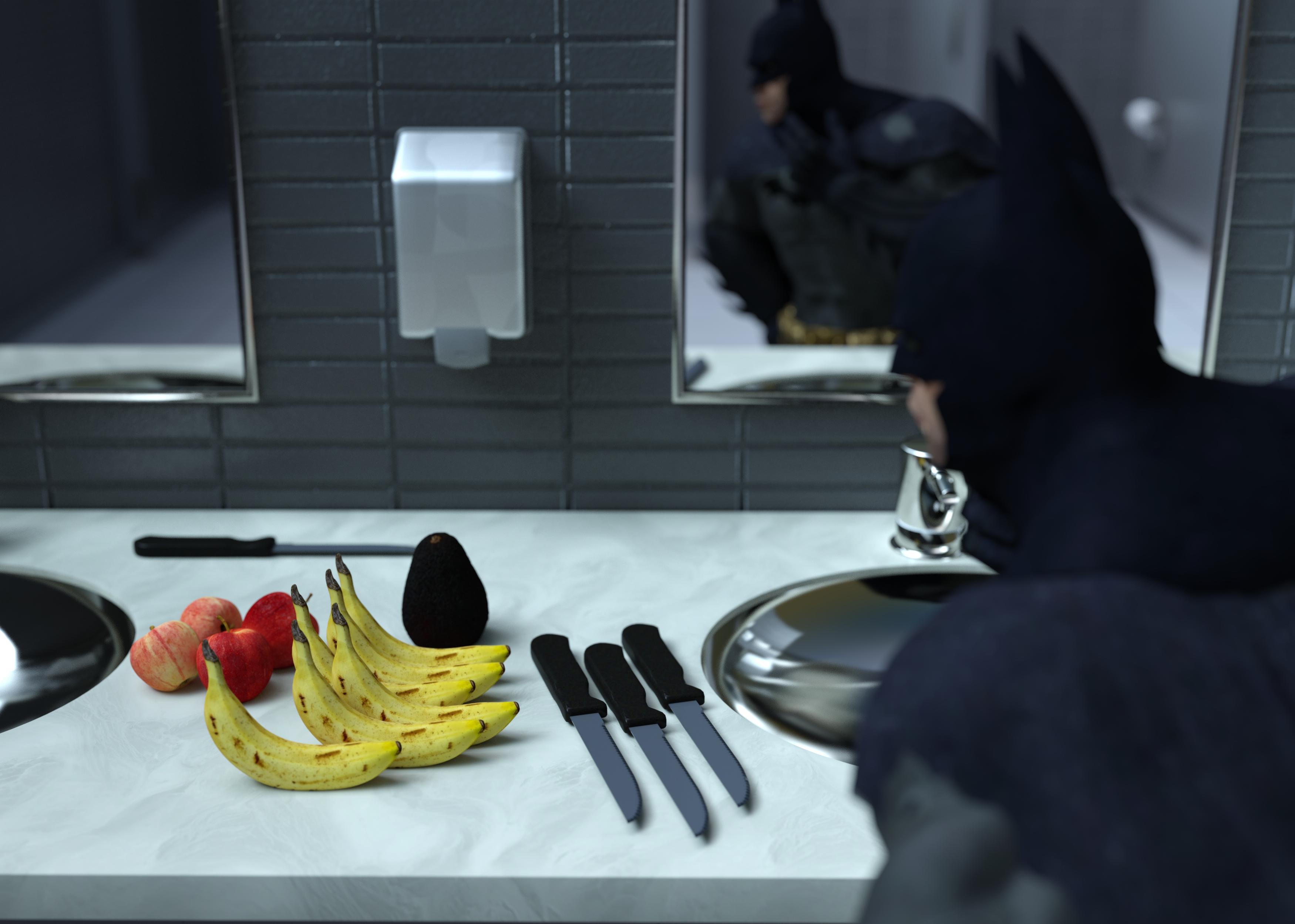

  • P A Y A T   PP A Y A T P Posts: 1,185
    edited June 2025
    Thank you for this script. I rendered it for trial. It is very helpful in making instances of the same prop or character. Each instance can be independently repositioned or rotated to various positions.
