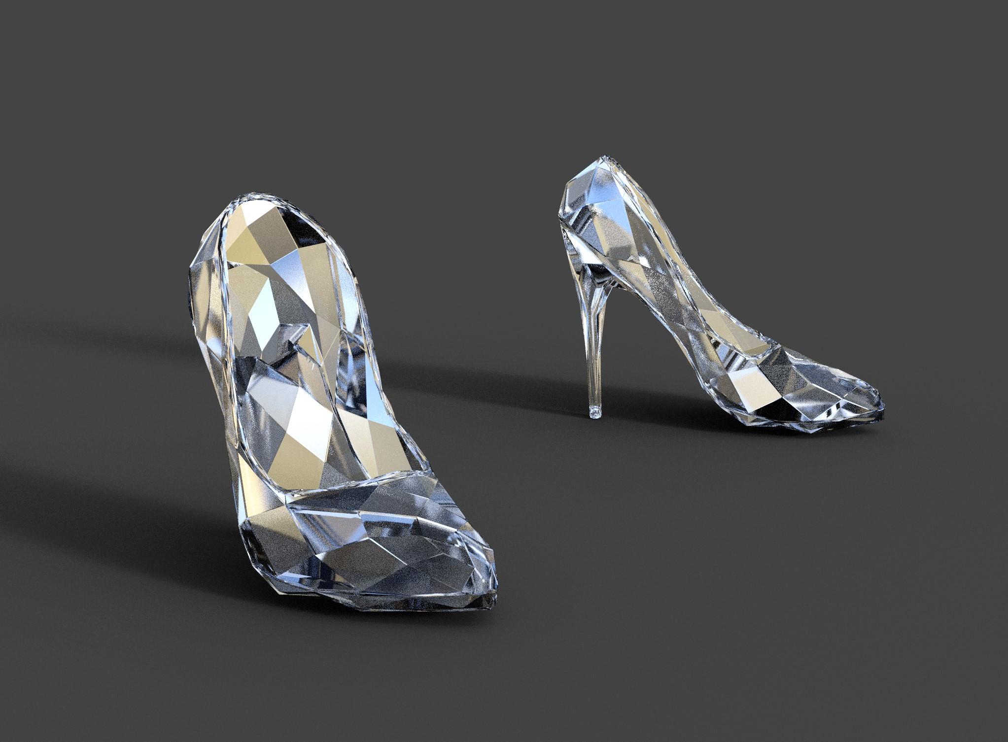

I am trying to create the glass slipper from the Cinderella movie with very little to no luck.
This is more of a Zbrush question than a Daz3d but all of my obj files are imported into Daz and Rendered.
Are there any Zbrush pros that could help me please.

  • IceCrMnIceCrMn Posts: 2,334
    Would simply applying a glass shader to an existing model be sufficient or are you looking for a model that has the faceting like in your example image in the first post?
    Thats how I make glass slippers so was just curious.
    maybe adding the faceting to an existing model that is readily available for the character you want to use it on would save you some time instead of making a new pair from scratch?

    Mostly all of my models are from existing sets imported into Zbrush. A model with faceting would do fine if it is vertex and not square. That's the main problem I've been running into.
  • mmdestinymmdestiny Posts: 198
    edited May 2025
    Definitely more of a point modeling project.  Its surface is very geometric, you'll WANT low poly count on the surface to have an easier time setting the phong angles, and sculpting defeats that purpose.  You might try projecting or shrink wrapping a lower poly hexahedron sphere onto an existing model (with the heel hidden and with the opening closed off), and go from there with tweaking the points.  Then it's just a matter of opening the hole again and extruding. As long as your phong angles are good all that's left is getting the right Refraction settings.

  • Matt_CastleMatt_Castle Posts: 3,292
    edited May 2025
    How's this?
    Took the heels from the 1920s Boudoir Outfit to Blender and slapped on a decimate modifier on Lvl 5 Unsubdivide (odd values of an UnSubD modifier will tend to create triangular and diamond faces out of clean quad topo, and then I turned it up to make it blocky enough), then threw on a solidify modifer so it had thickness, then made the surface a thick refracting surface with no smoothing but a pinch of roughness.
    About two minutes work, really.
    2045 x 1506 - 349K
    Post edited by Matt_Castle on
