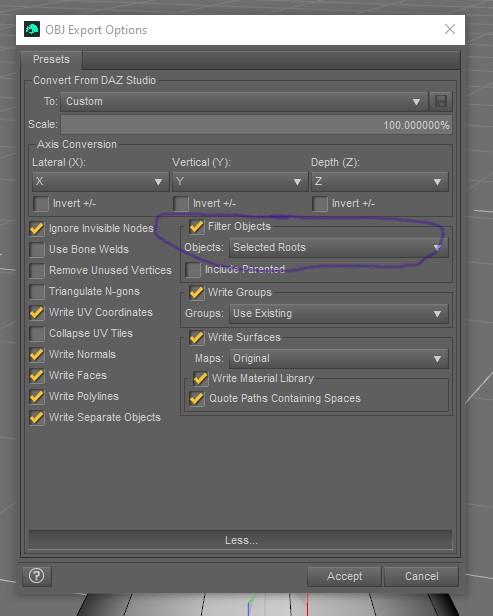

  • Richard Haseltine said:
    DS has, for a while, had an option to export only the selected item(s).
    Where is that setting located?
  • Richard HaseltineRichard Haseltine Posts: 109,502
    edited February 2025
    Filter Object(s0 on the right, assuming you have Show More on
    493 x 616 - 57K
  • Thanks richard for the correction.
