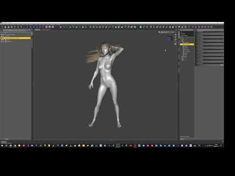

    I'm having a problem. When in one of the magic cameras, say I do a hair blow morph, then I switch to the Perspective View camera and tweak other things, then I return to the magic camera, but the dialed hair blow morph is gone. Please tell me how to fix this cos it's really going to affect whether I can continue using this product. I need to switch to the Perpsective view every now and then to make adjustments. EDIT this also happens when a switch to another magic camera when i apply the hair blow morphs from the previous magic camera.

    Hi. What hair set is this....Also what setting did you ask the camera to remember?

    Liv hair by outoftouch, but I don't think it matters? I asked Camera Magic and Camera Magic Plus to rememebr visibility data and shaping data. I have two cameras that have the characters wearing different clothes and having different body shapes, so naturally I'd want changes to the hair morph to be reflected in both cameras, and not disappearing when I switch cameras.

    Works fine here. Be sure to select All rigged assets....

    Nope, still not working. With clothes and shaping combination set 1, I save visibility date and shaping data (all rigged assets) to Camera 1, and clothes and shaping combination 2 is saved to Camera 2. I dial a hair morph either in Perspective View, Camera 1 or Camera 2, and the moment I switch to another Camera, the morph is dialed back to zero.
    Edit: to clarify, with Camera 1, I enable visibilty data saving in Camera Magic, then I go to Camera Magic Plus and save visibility and shaping data (all rigged models) to Camera 1. Then with a different clothing and shaping set, I repeat under Camera 2.

    "I dial a hair morph either in Perspective View"
    This needs to be done on the desired camera...perspective view will not hold any data.
    If you have Plus you dont need to use the standard Camera Magic anymore. The visibility/enable options are there in Plus. I don't know why it is not working for you. Send me a log file please. Under script settings/options there is a get log function.
