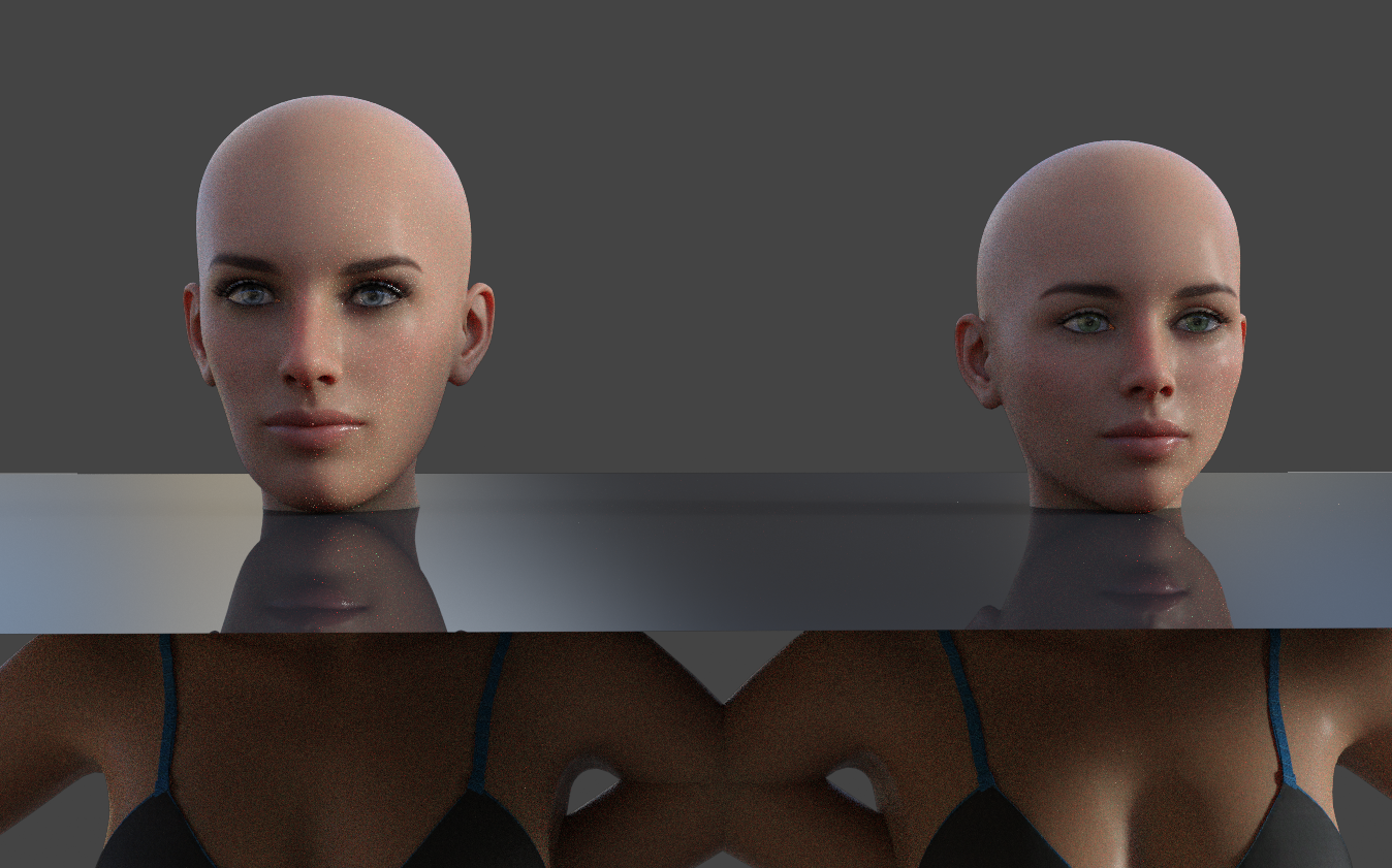

For reference, I pulled up a render from June and reopened the file just now. Ran the render with the camera in the same position.
The figures on the ends have morphs, including third-party ones, but they do not use Face Transfer. As you can see, they're unaffected and load as normal.
The figures in the center use Face Transfer and are both distorting in the same way.

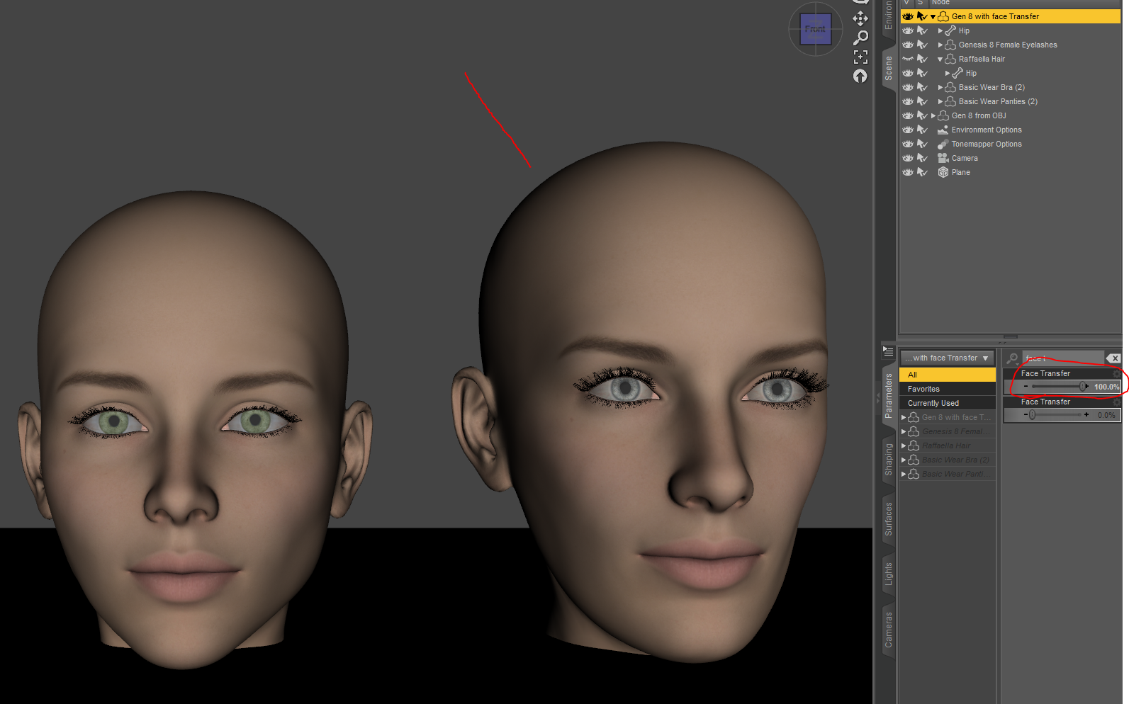

    So here's what I'm seeing on my screen.
    On the left (1) here is a model that I just made on Thursday using Face Transfer and Face Transfer Shapes. Here, FT is set at 100% and FTS Main at 79%.
    On the right (1) is the same figure as she appeared originally. I only know this because I exported the model as an OBJ into Blender and then reimported it into Daz using Morph Loader Pro.
    Both of these files were opened from my "Scenes" folder. When I saved them, they looked alike. Now... not so much.
    (2) is the same view from the rear. Note that the bulk of the distortion is in the height/length of the head.
    I went into the Shaping tab and noticed something unusual- Face Transfer was listed as '(2) Face Transfer 100%'. There was only one slider bar. I slid it to zero. Then, in the Parameters tab, I found the two Face Transfer sliders (3).
    It appears that when the figure is first loaded into Daz, Face Transfer option 1 is at 100% and Face Transfer option 2 is at 0%.

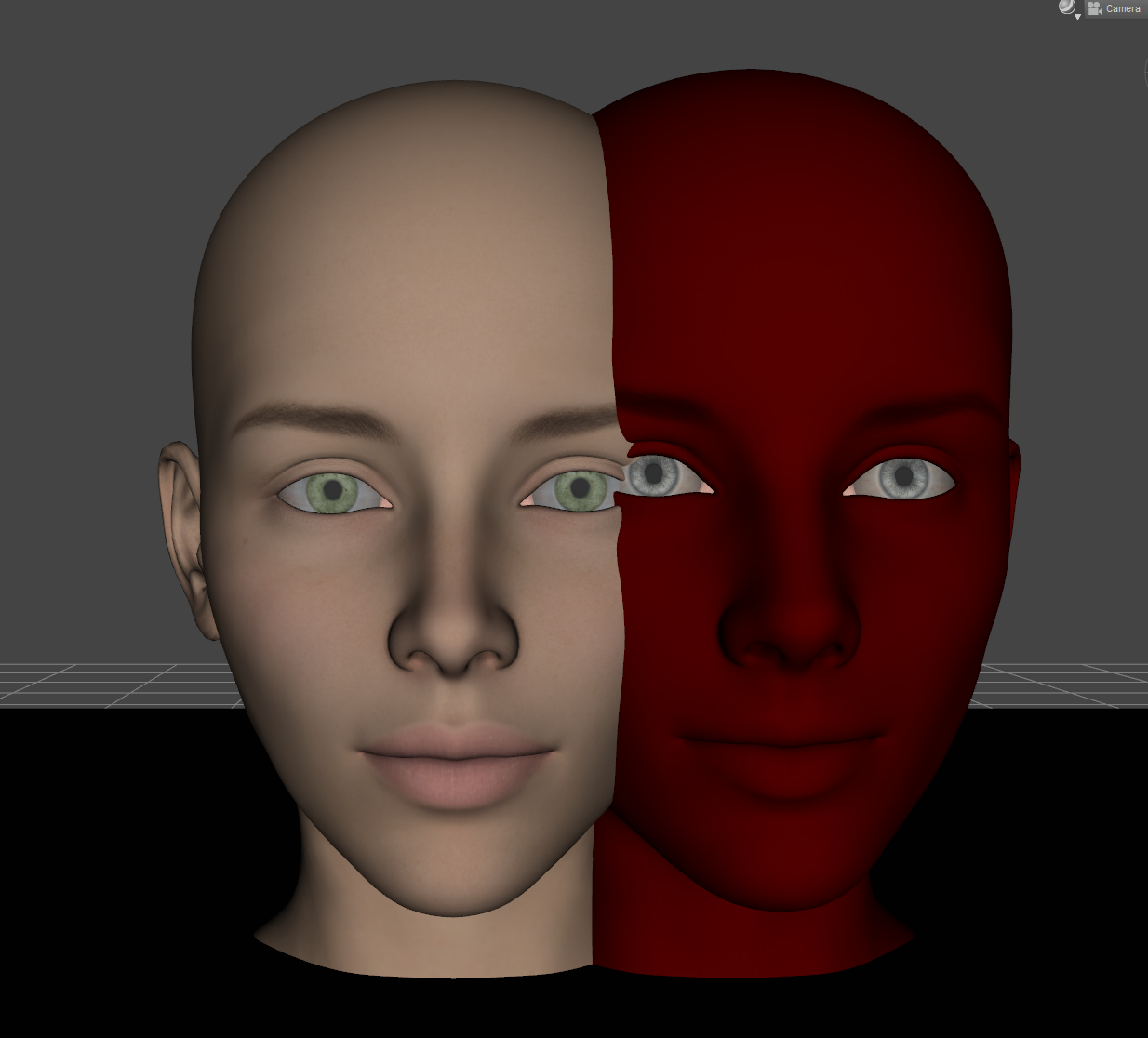

    In (4), the OBJ figure is on the left and the FT figure is on the right. Here I am using what Daz loads as defailt, "Face Transfer (1) at 100% and Face Transfer (2) at 0%.
    In (5) I have switched this around, with Face Transfer (1) at 0% and face Transfer (2) at 100%. Close! But, to my disappointment, no cigar. And I don't even like smoking!
    Image (6) gives you an idea of what's happening. The head is still distorted. The face is still too long, especially between the eyes and the chin, causing the eyes to be too high up on the face, and causing the cheeks to look rectangular. Essentially the same problem as before, only less so, but still very noticeable.
