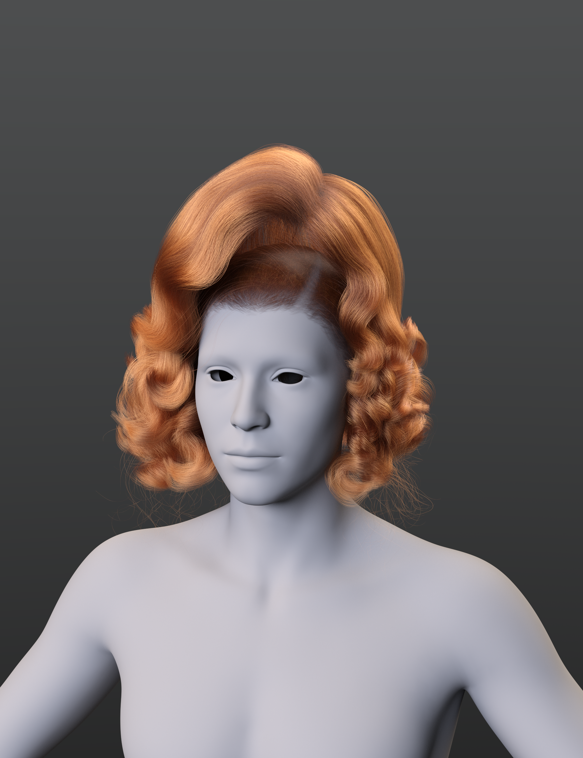

dForce Lanah Hair for Genesis 9 comes with lots of character morphs for existing Daz characters, but it won't autofit to ANY non-listed character that I have tried. This makes it basically a dead end product without the ability to autofit to new characters.
  • For example, try to fit Lanah Hair to the new Genesis 9 Base Anime Female. The hair strands embed in the head. Other dForce hair products I have tried from several vendors autofit to Genesis 9 Base Anime Female and other characters just fine. Something is wrong with Lanah Hair.
  • Lanah Hair doesn't follow proportion morphs like Proportion Neck Length or Proportion Torso Length on ANY character, even the supported ones or even the Base G9. Strangely, some wispy strands seem to be in the right place, but the main ones are not.
  I can't figure out what is wrong with Lanah Hair. Can you? I'll submit a ticket, but I don't get responses to technical support tickets anymore, so I'm hoping maybe someone here can figure out how we can fix it ourselves.

    The old forum bug is sometimes hiding my attached images from the first post. I'll put them here for reference.
    Base G9 Proportion Neck Length 200%
    Base G9 Proportion Torso Length -200%

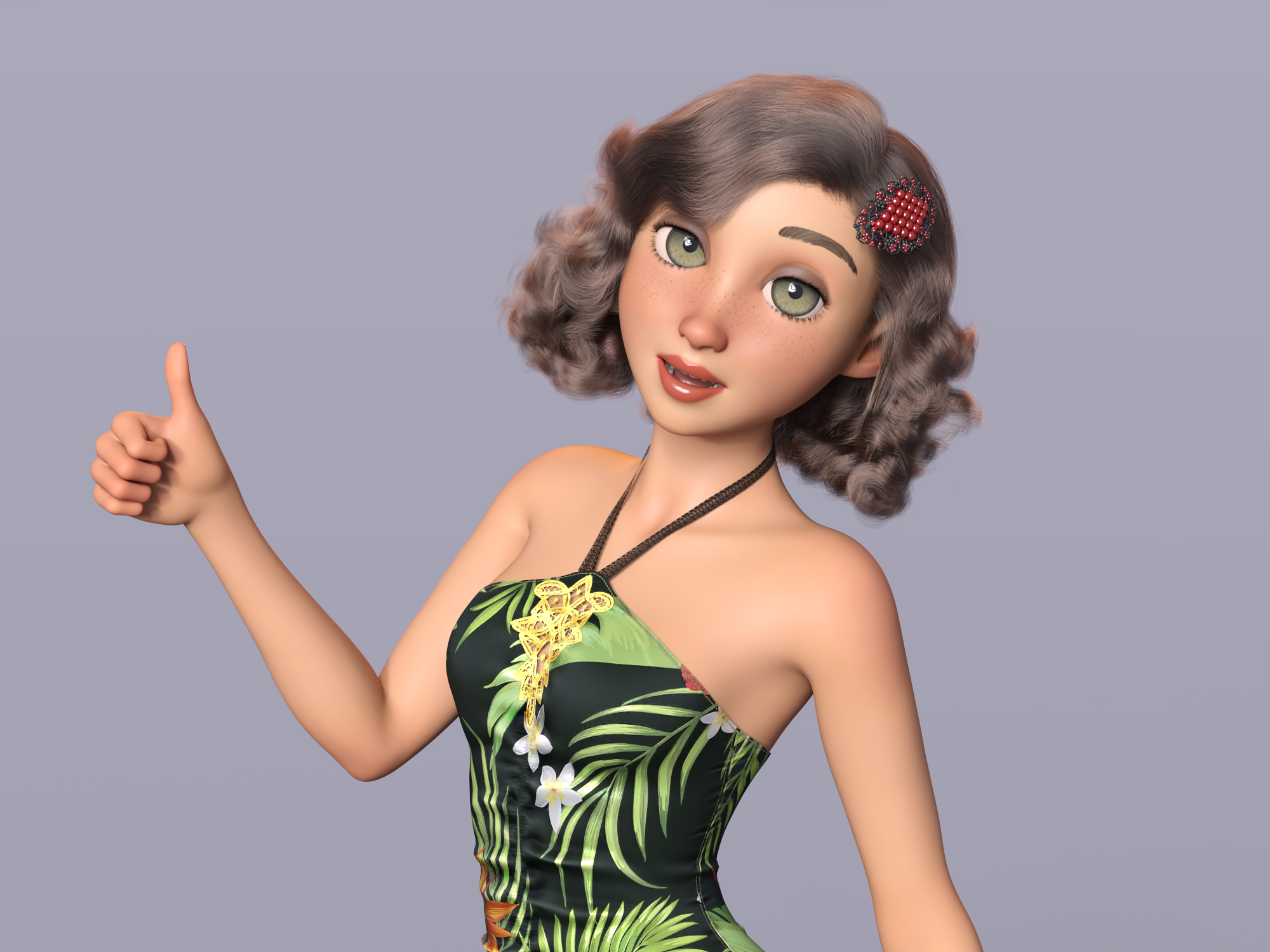

    I gave it a good challenge with a combo of 3DU Adult Toon Female and Bette converted from G8 to G9. I dialed in some proportion Neck Length and Proportion Torso Length. I added the hair clip and played with a few of the strand adjustments. I applied one of the presets to make it shorter. Lanah hair fix passed the test and gets a thumbs up. It also works well with Anime shape now with the temp fix.
