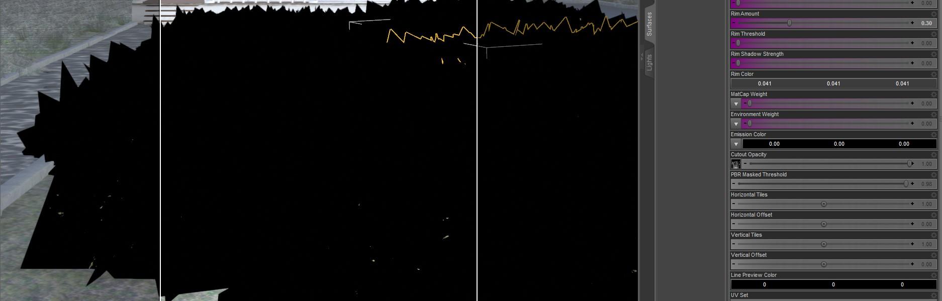

    Not sure if this has been asked has anyone worked out how to deal with flat panel grass with opacity textures, such as used in Harwoord House and FG's Haunted House? When I use Filatoon on such grass it just comes out as solid panels, and so far can't work out how to get around the problem.
    Post edited by Ghosty12 on
  • barbultbarbult Posts: 26,611
    Reload the opacity map.
  • Ghosty12Ghosty12 Posts: 2,081
    edited October 2024
    I do that well I sort of do by adding back in the cutout opacity texture used but I still get this problem.
    Don't use outline shell with billboard type items. If you want an outline on transmapped flat plane items, it'd have to be part of the base texture, the shell outline won't work

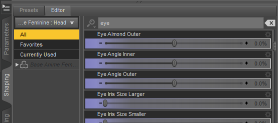

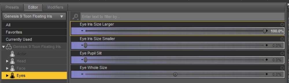

  • HighElfHighElf Posts: 373
    Is there a way to enlarge the iris with toon eyes? I have a few models that have larger eyes, but I can't find a way to scale the iris accordingly.

  • 3Diva3Diva Posts: 12,022
    edited October 2024
    In the Scene Tab select the "Genesis 9 Toon Floating Iris", then in the Shaping Tab select "Eyes" and you can slide the "Eye Iris Size Larger" slider up. You can probably turn the limits off if you need the iris bigger than 100%.
    edited October 2024
    3Diva said:
    Yes, that is it. But why didn't it show up, when I typed 'eye'  into the search filter?
    Anyways thank, you are a lifesaver for those toons in my library xD
    P.s.: The setting was hidden by default. Just in case anybody else needs those too.

  • TaozTaoz Posts: 10,300
    edited October 2024
    It does, if you search on "All", also with Show Hidden Properties disabled:
