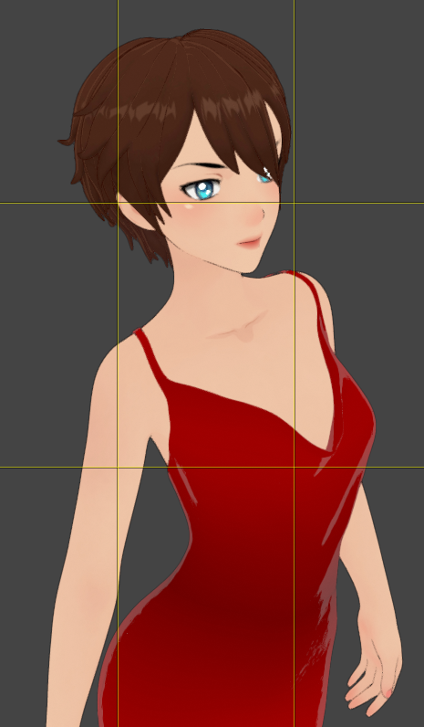

    Probably tweak them like these settings.
    This filatoon shader is very customizable, especially when there're lots of "styles" in toon / anime surfaces. Just have more experiment, you'll get it.
    Besides, Outline shell doesn't work well on sharp edges... optionally you can try thickening it.

  • Toon outline is achieved by a reverse-normal geoshell. Select the cloth, create the geoshell for it, then apply the outline shader to the geoshell. Geoshell offset is what creates the outline thickness.

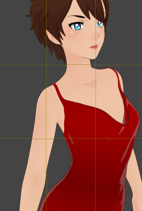

    OK thank you for the help I meant the outline shader
    If I add the filatoon shader to a piece of clothing it does not automaticaly create the geoshell is this correct as far as i can tell i have to manualy add it?
    edit the filatoon general shader adds it. more research required on my part but its promising

    ^There are presets that add the shader to the figure/object and add the geoshell at the same time (which sometimes needs offsetting for the lines to appear/thicken), and then there are shaders that just change the shader. The former is mostly what you need when applying to a new non-toon-yet figure in the scene (assuming you want the outline).
