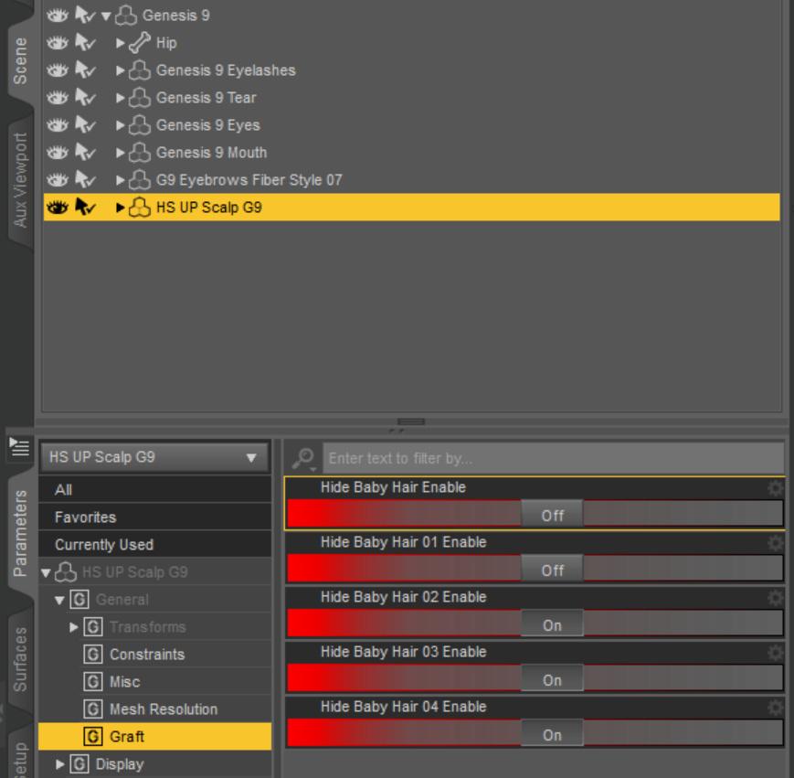

    After the hair is loaded:
    • In the Scene Tab select HS UP Scalp G9
    • In the Parameters tab select HS UP Scalp G9 → General → Graft
    • Switch the hair on/off
    869 x 851 - 145K
    Post edited by markusmatern on
  • Select the scalp in the scene tab then under parameters you have to un-hide the visibility of the baby hairs (can't miss them, they are all colored red) after that you can just click the little eye icon in the scene tab to select which baby hair you wish to show.
    Never come across this before,maybe having them hidden in the parameters tab saves on computing resources.
