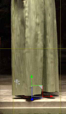

I appear to to getting a lumpy skirt as per the attached picture any ideas what i am doing wrong? :)
the dress is Lullys Tadema dress https://www.daz3d.com/dforce-tadema-dress-for-g8f
I have tried deleting the dress and reloading it but the lumps remain.

  • Richard HaseltineRichard Haseltine Posts: 110,912
    I am not seeing that. Are you sure there is only one copy of the dress? Which materials are you using?
  • PitmaticPitmatic Posts: 1,020
    I am using the default materials with the dress, the figure is Van helsing and the dforce simulation is current frame as its a simple standing pose
    One copy of the dress

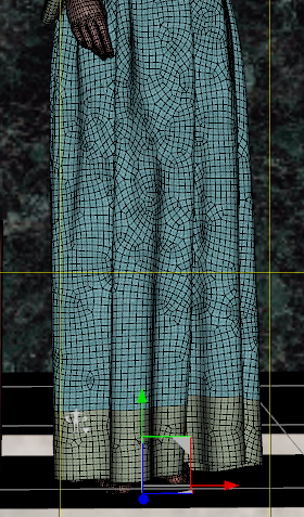

  • FirstBastionFirstBastion Posts: 8,072
    Can you switch from texture mode to hidden line wire-mesh and take a screen snap?  And is there any kind of displacement map or strong bump map being used in the surfaces tab.

    So this the gen 9 figure with the lumps

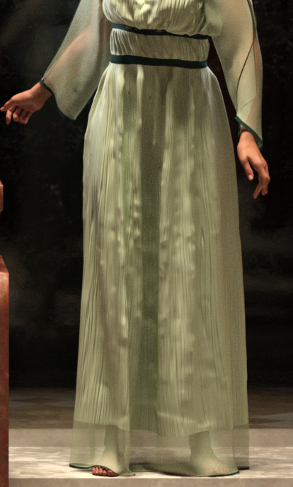

    this is gen 8 with the lumps

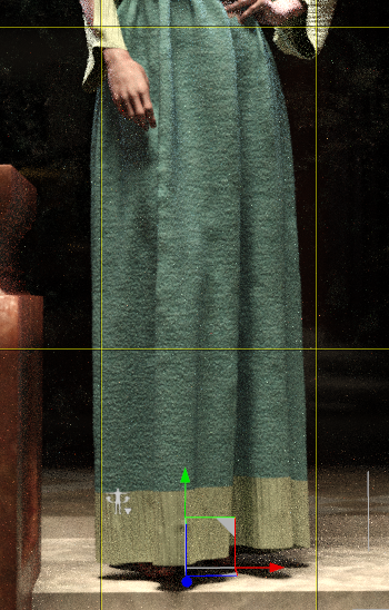

    this is gen 8 with a fabric factory shader
    and this is the wireframe
    I have done several scenes with gen 9 in this dress and no lumps but in this scene the lighting is from above and is showing them up I think now i got annoyed lol and set smothing to max and that did remove the lumps but should not be required I would have thought maybe?

  • Faeryl WomynFaeryl Womyn Posts: 3,761
    That is a strange looking mesh to me, why is it not all straight lines up and down as well as straigh across. It looks messy and can be what's causing your problem.
    It's originally made in Marvelous Designer. I would be very surprised if the mesh is what's causing the issue. I have used the Tadema Dress quite a bit over the years (it was released in 2018) and have never ran into this issue.
