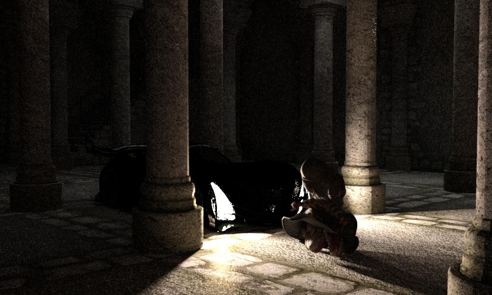

    I tried removing the ceiling but it didn't look right. I am now experimenting with the Dome Finite Square setting which is a box dome that can be set to fit inside the room with an HDR attached just the same as the normal dome and the lighting from the HDR will then be inside the room.
    This is the room now with fill light coming from the HDR inside it, nothing removed. The only light is from the car lights and the HDR. The image is still grainy as it stopped at the 2 hrs. I am now running it, hopefully, until it is fully rendered.

  • AndyGrimmAndyGrimm Posts: 910
    looks way better now - but the car is a little bit to dark to my eyes...      good idea using a box dome.

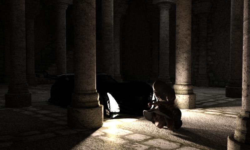

    Just over 5½Hrs. Not much difference from the last one.
    800 x 480 - 237K

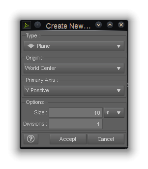

    One of the nice new features in 4.8...the ability to set the primary axis when creating primitives...change the axis, instead of flipping the plane.
    301 x 343 - 16K
