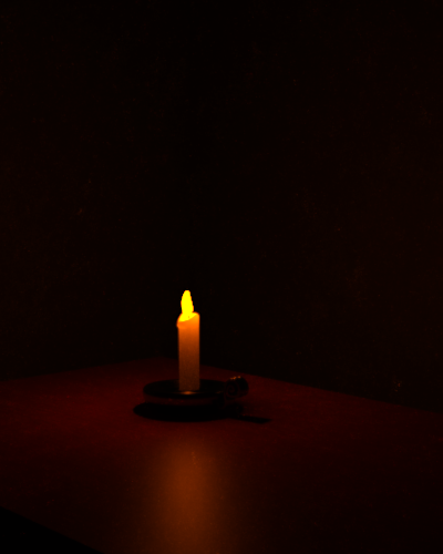

    I couldn't find the old Luxrender image...so I ran this one overnight.
    It doesn't have the IES profile I wanted to use, so I ended up trying a different one...added bloom and the 'rays' through Lux....if I can convince my son to let me borrow his computer, with it's nice shiny 4 GB 970,  I'll repeat the scen in Iray.
    400 x 500 - 60K

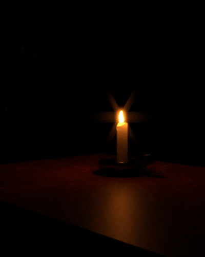

    edited July 2015
    After about 8 hrs in Lux, I called it 'done'...here it is with the candle being 1 m from the wall.  I still need to transfer the scene to the Iray machine.
    Lux Camera settings....
    ISO:200
    Shutter: 1/15
    f-stop: 5.6\
    The color temp is 1900K on the light.
    400 x 500 - 114K
    Post edited by mjc1016 on

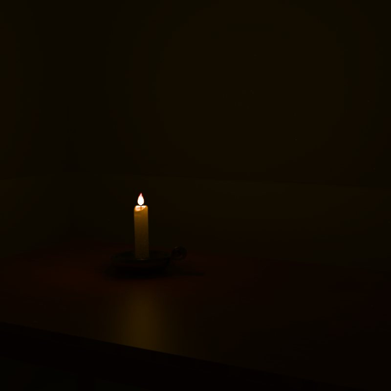

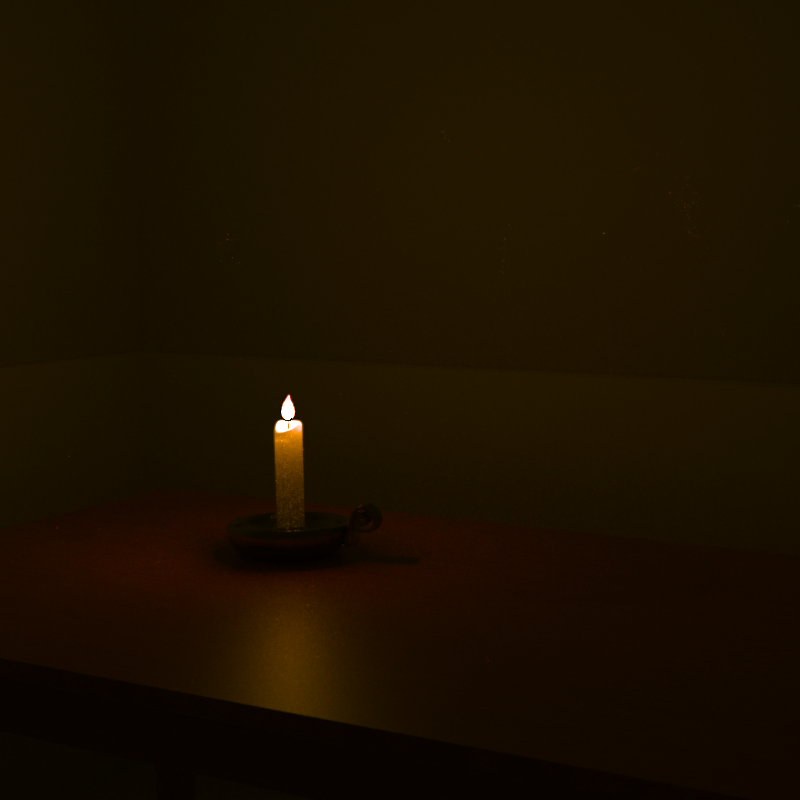

    ok - based on my reference picture i came up with this (following) real world values... and suddenly i understand more about the mesh ligths smiley
    Realworld Camera Settings Reference:
    Shutter 1/30
    F-Stop 2
    ISO 800
    I set up a wall corner - each wall is 2x2 meter....   the ligth is in the middle 1meter away....
    Picture 1 is a pointlight 10cm above the floor - i used for wall and floors - IRAY stucco....   i dont take care about the scale of the materials texure - but the reflection comes realtively close to my photo test....
    Picture 1 = pointlight 15 lumen - color 2000k.
    Picture 2 = candle flame (no wax body, just the flame)...
    The light colors come from the added (as real as possible flame texture)... because i use real colors (improving here, see the added modelled flame) i need to set emission color to a cold white (aka a thungsten color neutral 5000k)
    The flame is about 2 cm2 in a 2d projection... so i must set 7-8 luminance and change to cd/cm2 (means now approximative lumen/cm2) and come close to a 15 lumen candle.... when i am happy with my candle flame i will post reference image and the flame as a download here.
    Picture 3 - the flame mesh SCALE gives me now the lights power - ..   to show that - i just scaled the flame with factor 10....not bad for animated flackering or variations..
    Because the flame is a mesh - a normal IES profile will be distorted (dosent make sense).... but still i think the ligths  fall-off is not 100% correct  - need to do more work on the flames mesh and maybe create a custom fall-off Ies profile.
    1366 x 684 - 160K

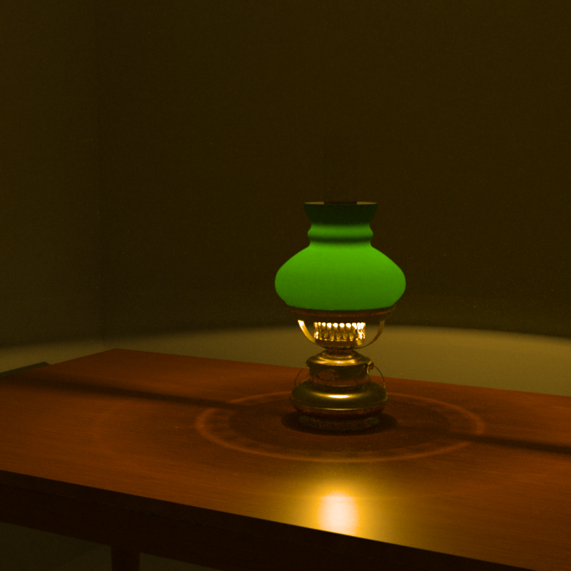

    Here's a lamp render....
    800 x 800 - 614K

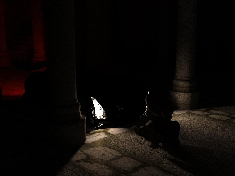

    I've been playing about with lights inside an enclosed building. The lights are emitters on the head and tail lights and I have got it this far, now I am trying to get some ambient light from an HDRI plugged into the Environment Map.
    800 x 600 - 228K
    Post edited by Fishtales on
    In an enclosed space, an HDR isn't going to do much of anything.  It's lighting the OUTSIDE of your 'building'.   You either need to remove a piece (wall/ceiling/etc) or add windows/doors/other openings.
