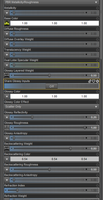

    As far as the retroreflective properties, this is what I had.
    As far as fluorescence though, I'm not yet sure how to replicate that well, so I didn't try. Adding emission isn't really accurate, because fluorescence doesn't *make* light, it takes one wavelength of light and then emits it at a lower frequency (usually taking UV or blue light and emitting it as red, yellow or green. Fluorescent blue is rare, as blue photons would have to be activated by UV, which is a small portion of a typical light spectrum). There's no proper function for that in Iray Uber, so I think I would actually need to make a custom shader block that could take intensity from the blue channels and add it to the red or green channels... and I'm not even sure if swapping light between channels is possible.
