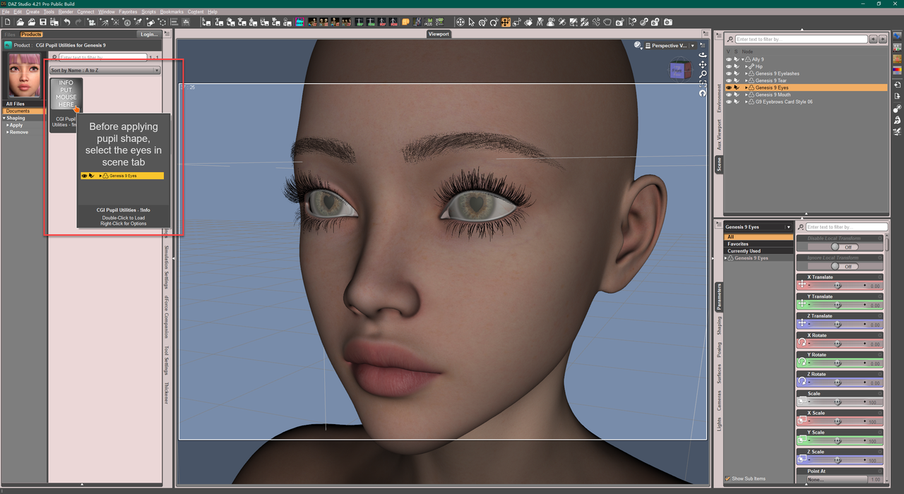

As per title, I've done as the Help tile [for CGI Pupil Utilities for Genesis 9] says and selected the Eyes. When I click on the morph I want, it does nothing and I cannot find any sliders for them in the Shaping nor Parameters Tabs. What am I missing?
  • Richard HaseltineRichard Haseltine Posts: 111,444
    That seems to be a product error - the morphs are in \data\daz 3d\genesis 9\genesis 9 eyes\shapes instead of \data\daz 3d\genesis 9\genesis 9 eyes\morphs, as far as I know that will not work. If you isntalled manually of through Daz Central/DIM you could, on Windows, try renaming the Shapes folder to Morphs (assuming it has only that product's morphs) or just drag the /color galeria/ folder across to the morphs folder but I will flag this up.

    The utilities/poses/whatever are found on the Parameters Tab under Head > Eyes IIRC -- with the "eyes" selected in the Scene Tab. [that's the Eyes, not G9]

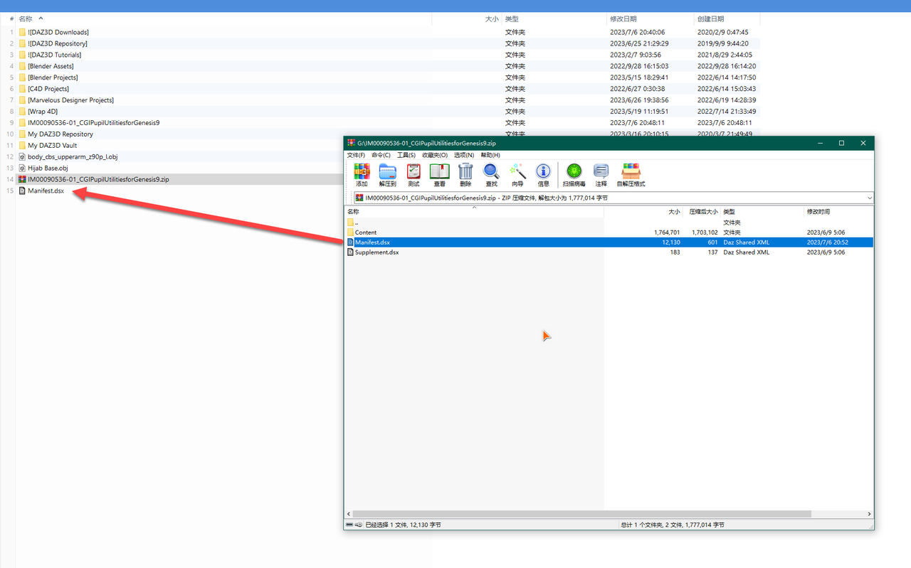

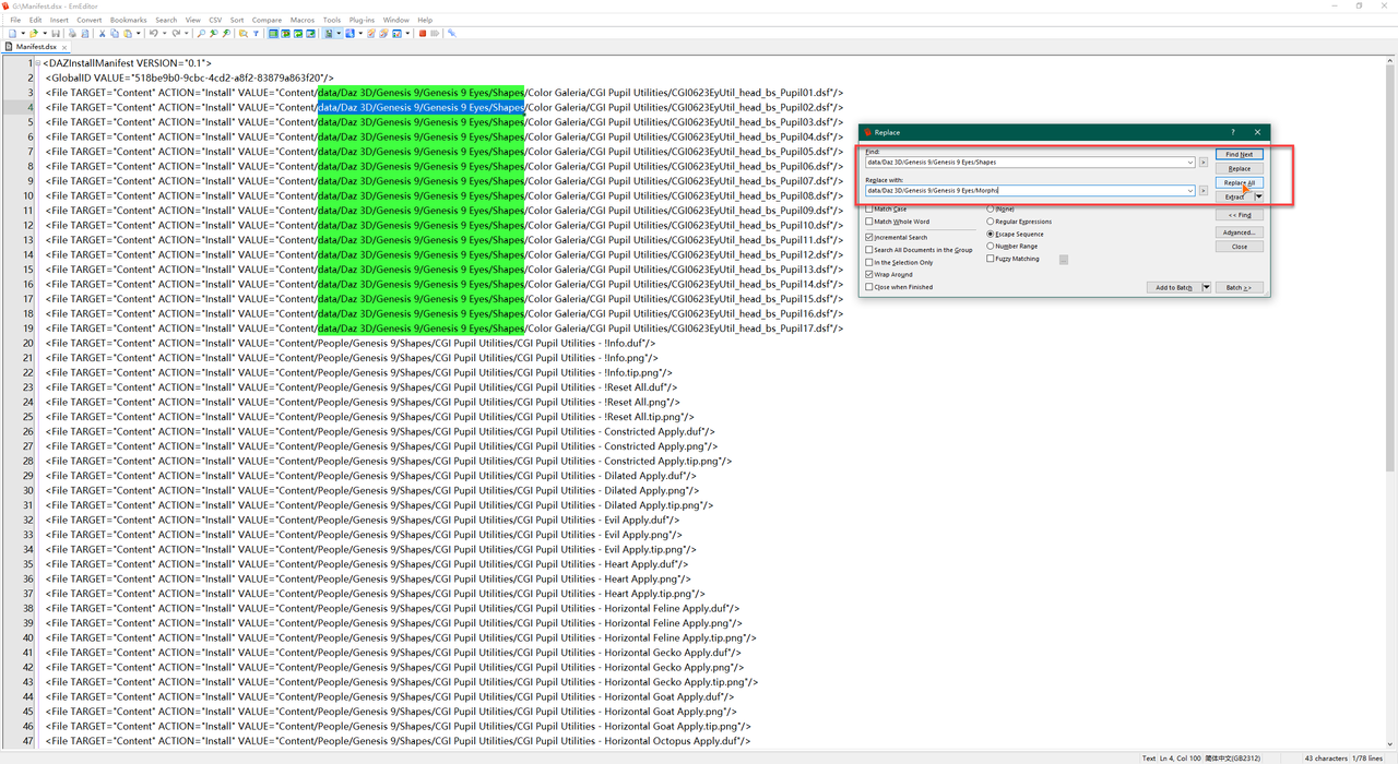

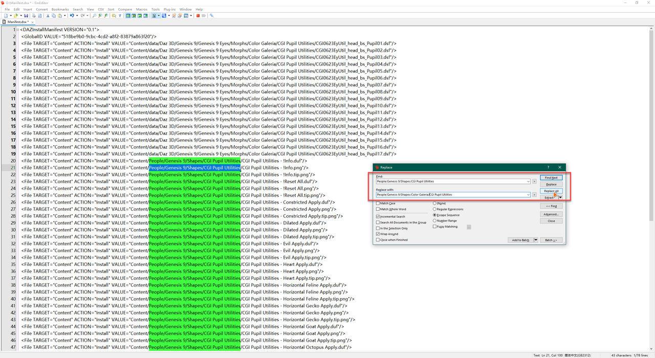

    Checked... fainted... errors again and again these days... The IM package is very wrong, the needed files could not be installed to your library, the product could not be seen in Smart Content... If you don't wanna wait for the 'fix' ~~~
    1) As usual, uninstall it with DIM! and download the 'updated package' dated July 5th. (still wrong)... Drag out Manifest.dsx from IM00090536-01_CGIPupilUtilitiesforGenesis9.zip (in your Package Archive folder after downloading with DIM)
    2 ) Open  Manifest.dsx with an Editor (EmEditor, Notepad++, etc.), replace "data/Daz 3D/Genesis 9/Genesis 9 Eyes/Shapes" with "data/Daz 3D/Genesis 9/Genesis 9 Eyes/Morphs" , then replace "People/Genesis 9/Shapes/CGI Pupil Utilities" with "People/Genesis 9/Shapes/Color Galeria/CGI Pupil Utilities". Save! Then drag Manifest.dsx back to IM00090536-01_CGIPupilUtilitiesforGenesis9.zip, and move the IM file to your Package Archive folder, overwrite.
    3) Install with DIM...
