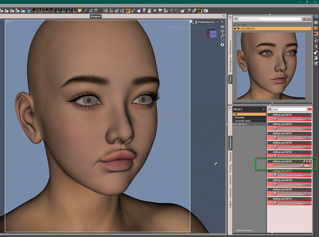

    Yes the head is a single dial. The lips that I used for the model on the left are from the Big Lips Morph by Anagord. So I wanted to just apply that straight to the model on the right. But for some reason whenever I try to apply the big lips morph to the right model the lips don't change. I'm assuming that's because the head is a single dial set to 100%? It's just annoying that the lips won't change when applying the big lips morph.

    I don't have the figure in the right though she looks very familiar to me... who's she... I'm old... I just use another Char to test, it seemed working.

    If it is just a lip morph, then you should be able to apply it to the other model as long as they are both the same generation.  Keep in mind that since the two have different face morphs,  even if youi do get the lip morph to work, it might not look the same as it did on the other model.

    Exactly, as FSMCDesigns mentioned. So normally we will sent to Zbrush or Blender to sculpt more.. for in such a case of using a Custom head morph, the technique of removing vertices of Lips' shape won't work...

    Yeah so I figured out what the problem was, instead of applying the head (double clicking on smart content) I just used the face slider on the gen 9 dev load which then allowed me to apply the lips on top. For some reason if I apply the face morph from smart content it doesn't allow me to apply the lips but if I do it the other way I mentioned I can apply the lips.
