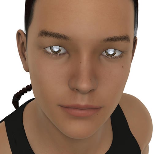

  • DaWaterRatDaWaterRat Posts: 2,882
    edited August 2012
    I haven't tried it, but turning up the reflection on the Iris should work. It may take a bit to get it to look right.
    edit: Okay, I was going to work on some characters today anyway, including ones that likewise might have glowey eyes.
    It needs a reflection map, as opposed to ray-traced reflections (I think. I didn't try it with a full scene). Specular was white at 50%, map was from Bice's Shiny Freebie over at Renderosity.

  • SpyroRueSpyroRue Posts: 5,020
    Wow.. that's beautiful!, I'm trialling what you suggested as we speak :) Thanks for your fast response :D

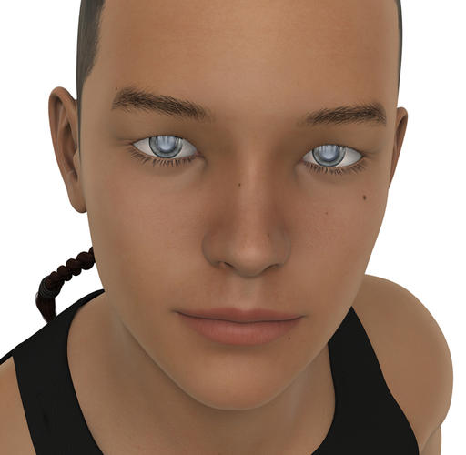

    Heres the first draft render lol... Think I need to reduce the reflection lol
    800 x 781 - 284K

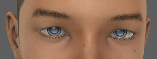

    Here's draft 2 Render, Added some colour, More a pale blue than green though... I reduced the reflection, and set a medium blur.
    Might add a black inner shadow on the map, cos it seems to have a defining white stroke appearing on the outer edges.
    800 x 781 - 280K

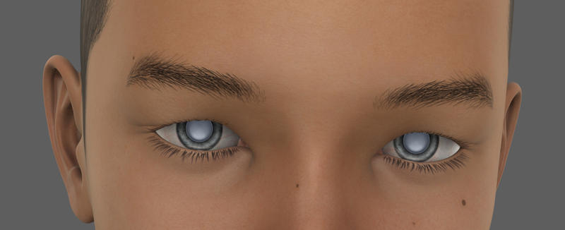

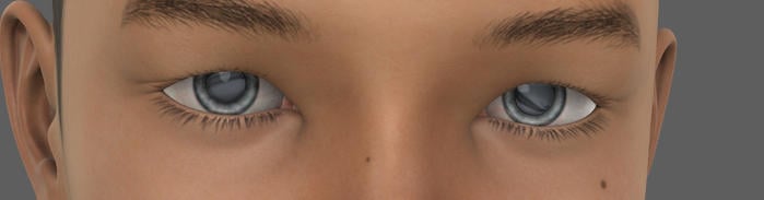

    Just re-dit the eye itself, using parameters from M5 Philip... Notices my eye settings were seemin rather off.. By the looks of this render some of my lights arent set for shadows perhaps... Getting strange light on the sides of the eyes
    800 x 326 - 133K

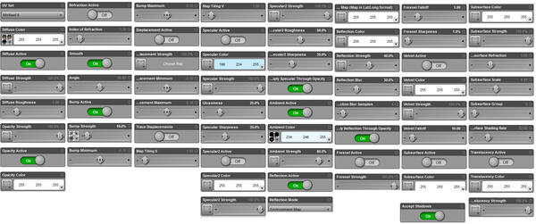

    Okay... Thats Trippy lol At least by using the ambiant Colour, In which obviously it neads to be mapped accordingly with M5 texture, I'll have greater control over the appearance and intensity. I'll toy around with this for a while :) but alas it is now 5am in Australia... and I must sleep! Thanks for the help guys :) And the cat Chohole LOL! I'll be back tomoz before work.
    699 x 183 - 79K

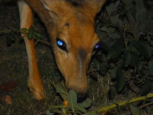

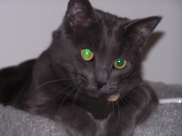

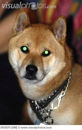

    Just a few Inspiration Pics...
    Notice that the angle of light has a great affect on the eyeshine. The Leopard and the greyish-black cat are great examples of this.

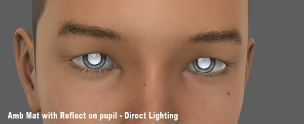

    Okay here's draft 4a3 lol... Playing with Ambiant Map, What I did was paint the eyeshine in Photoshop and mapped it accordingly with M5. I think it's good this way that it's controlable, the downside is that every different render/scene will require a new eye shine map appropriate to the scene. Any way here it is...
    800 x 800 - 97K
    672 x 257 - 102K

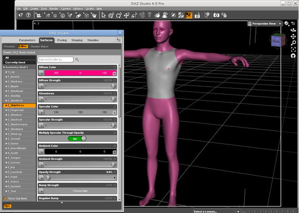

    This is DS4.5 specific: Select your figure and click on Create->New Geometry Shell. This will create a shell around your figure. Now, hide the unneeded areas using whatever method(s) you prefer (in DS4.5 there are a plethora of methods). Then on the remaining surfaces you can get as detailed as manipulating the properties of the individual polygons using the polygon group editor, or as coarse as you want by using existing regions. In any case, change the eye surface's properties to what you want/need. This is the fun part! You'll be surprised at what you can do with layered geometry shells... heh heh heh (evil laugh).
    EDIT: I've attached a screenshot where I've created a Geom Shell, colored it Magenta, and set the Skin Torso surface Opacity to 0. This took all of about 30 seconds to do.
    Kendall
