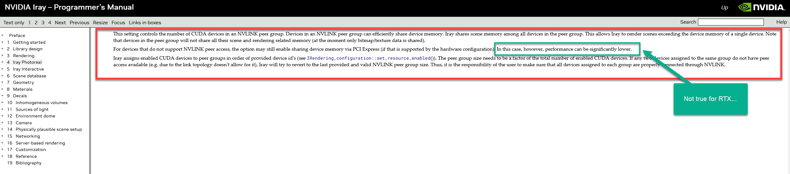

    First pls check this link: https://raytracing-docs.nvidia.com/iray/manual/index.html#iray_photoreal_render_mode#5230
    I still have not dropped my two old Quadro 6000 because they're stable and useful, however, I sold my Nvlinks long time ago... In most cases, well use the hardware on hand may be an optimal way... But still, you have to make sure your 'scene size' could be controllabe. If you really aim to make and render big scenes without loosing 'quality', there'll be no better way but just go for upgrading your cards. For 'big scenes', VRAM is the king ~ cool
