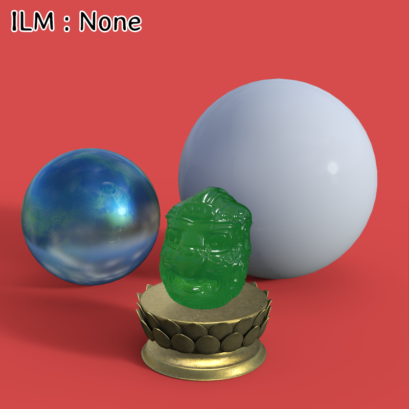

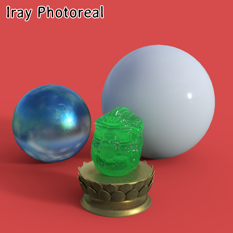

    I just posted the different indirect light effects as below...
    Indirect Lights are 'simulated' with Interactive Biased Mode (non real PBR). The default Diffuse & Glossy may have the 'better effect' but it will take more time to render, so it's up to your preferences...
    Comparing to Photoreal, there's no real SSS effect and related shadow in Interactive Biased, and the 'simulated glossy effect' is also 'fake' which is not based on real physics-based raytracing...
    As for 'hidden properties', yes there're but they depend on the Render Mode you select and/or the parameters you set. There's no 'Edit Mode' in Render Settings.
    PS: The test scene uses the default HDR + one top spotlight...
    800 x 800 - 325K
