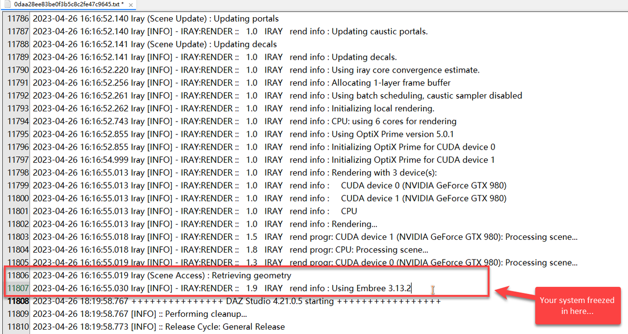

    Check from the line 11806... while the iray engine started to process your scene on grphics cards and CPU (you ticked CPU), your system freezed. It might result from the lack of VRAM / RAM or CPU problem when the engine started using Embree on it.
    You may check the Windows dump file to see what caused system crash on earth.
    Still, suggest you first uncheck CPU in Devices list and try again...
    Besides, there're 1.8K texture maps (line 11771)in your scene, you better use Scene Optimizer to downsize those big maps at least (4K) otherwise you GPUs have no way to hold them all...

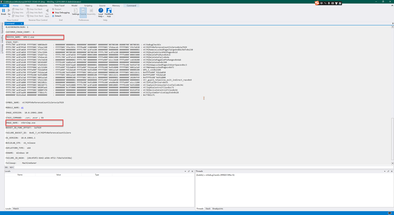

    Now, suggest you refer to this link: https://www.windowscentral.com/how-open-and-analyze-dump-error-files-windows-10, use WinDbg to check the minidump files. The analysis may tell you what caused you system freeze and crash...
    Just now, I 'made' GPU-Z bring me a crash. I checked the dump file and it showed me the reason and clues... like this:
