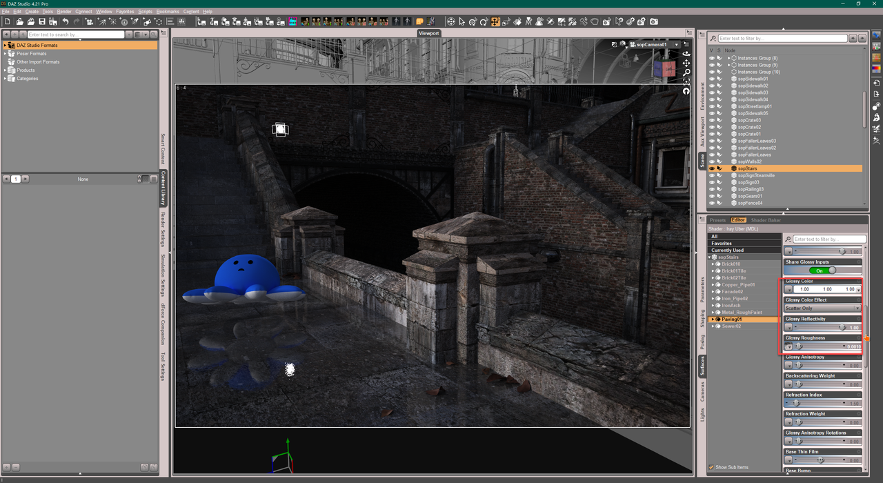

    thanks for your reply, not a lighting issue, you should see the wall reflected in the flat pavement, and I turned the exposure up to show the issue, so the overexposure is not what I am looking at
    Here is a screen shot showing the settings for the pavement, the flat surface as in the circled area in the previous
    Gloss color is white, reflectively set to .54 which should make it pretty reflective, I also tired 1.0 still nothing
    1920 x 1080 - 588K
  • In this screen shot, I set Reflectivity on the far wall to 1.0 and set a cube next to it
    I would think I would see the cube almost in a mirror
    On a previous try I set the Normal map amount to 0 (off), didn't seem to have any effect
    984 x 787 - 739K

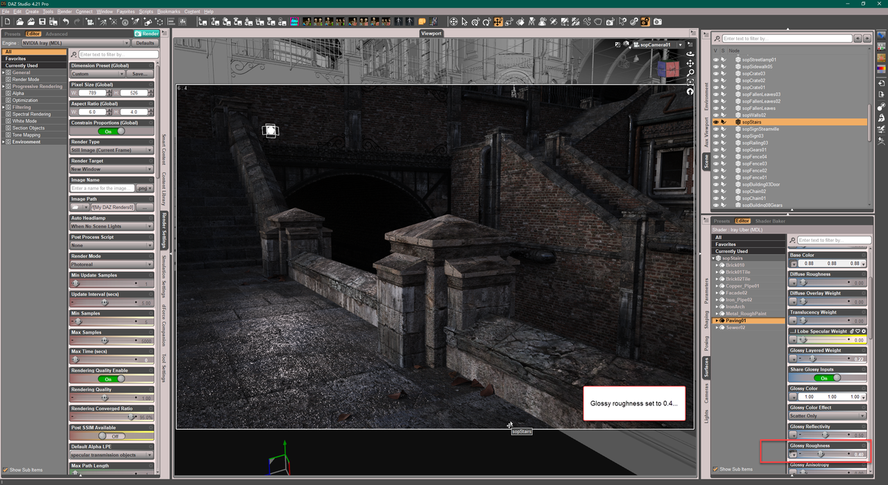

  • crosswindcrosswind Posts: 9,745
    edited February 2023
    I roughly did like these:
    The principle and mechanism are all the same, not just in iray ~~ BTW, placing some puddles there might be even better ~

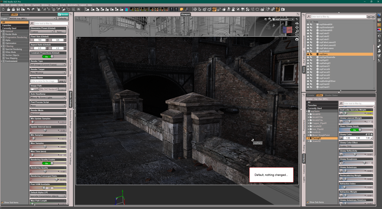

  • here is an image I made, the deck has a fairly high glossy roughness and medium low Reflectivity, and you still se quite a bit of reflection, for example the boot of the foreground figure
    2000 x 1600 - 1M

    That's a pavement with bumps on it, you wanna make it like a mirror ??  Of course you can, but will it be realistic? Unless it's covered by water or frozen sth. like that~~
    Normally 2 types of reflection, specular refl and diffuse refl. This pavement is typically the latter 'cause it's not that glossy in reality. It's not like that deck which does not have a 'bumpy surface' on it.  If you wanna make the pavement much more glossy and reflective, as you said, zero the Normal and Bump values if there's any or sharply decrease them...
    Post edited by crosswind on
  • That is almost what I am looking for, to make it look wet, not quite so smooth of course, I have set reflectivity to 1 and glossy roughness to 0 and deleted the normal map, still not like your image, what am I missing? Is it possible there are settings in Render settings?
    I will model some puddles
