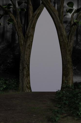

    Revitalizing the thread because I am doing something wrong, lol.
    My brain goes numb at the mambo-jumbo in any lengthy light or shader tutorials. But I need a flat plane to glow and create a white light in a night time scene. It's a portal between two trees, to another realm, but it has to emanate its light on the existing setting and figures.
    I'll adjust the lights I am using to see my scene after I make the portal glow/emanate white, as well as prop textures. I just think adjusting those after I create the portal light makes more sense.
    To give you an idea ...
    600 x 900 - 335K

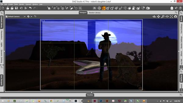

  • WillowRavenWillowRaven Posts: 3,787
    Not sure what you are asking... But here's a screenshot...
    The purple/pink light on the bottom and bottom-side of the ship have a glow shader on them, but they don't emanate light, like real lights would.
    I've never used linear point lights, but would that work if I shaped them like the geometric material zone shapes that 'glow'?
    1366 x 768 - 112K

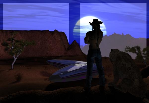

    edited April 2015
    I don't know what my mental block is with this, but every time I try this, it messes is the other lighting in my scene.
    Anyway ... I like the look and lighting of everything here except the shadow and area below the ship.
    Is there a way to make the shadow purple, as if the area is illuminated by the lights above it. If so, I can fudge the rest in Photoshop.
    Also, how do I undo a convert sub D? I think I liked the jagged edges better.
    722 x 500 - 175K

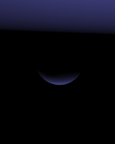

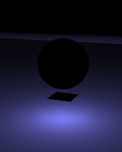

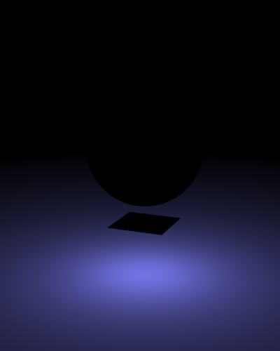

    The first image is just a plane with the Area Light applied, as loaded and tinted purple.
    The second is the same plane rotated 180 on the X axis.
    The third is the same as the second, with falloff active, set to 1 (linear), start distance = 0 and end distance = 500.
    In all cases the samples were upped to 64, from the default 8.
    The third one shows the effect I want best, but not from a plane ... from the ship itself.
