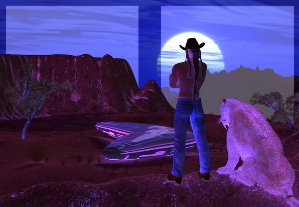

    That's what you see in the render ... that's the glow shader I have on the lights. They don't cast light anywhere, though. They just look glowy on the surface, which I like. But I also want light to emanate from the purple glow area.
  • WillowRavenWillowRaven Posts: 3,787
    I was using it wrong, it appears. I didn't realize I had to load the UV light separately. But I'm not sure I like the effect on the rest of the scene ...

  • Charlie JudgeCharlie Judge Posts: 13,629
    edited April 2015
    The UV light is adjustable and poseable. You could try selecting the light and adjusting its parameters
    See also this thread for some help on how to use them:
    http://www.daz3d.com/forums/discussion/26261/P15
    Post edited by Charlie Judge on
    I'd start with turning Falloff on, setting it to 1 (linear) and with a start value of 0 and end value of 1500 or 2000...(DS is in cm, so that value would mean 1500 cm...or 15 m). That would have the intensity of the light decrease over the distance instead of continually being at a constant value like it is currently. That should help it quit lighting up so much of the background. In the third image I posted before, you can see where it no longer lights up the walls, like in the second one. I would probably play around with changing the falloff distance in steps of 100, until I got close to what I wanted, then in steps of 10 to 'fine tune' it.

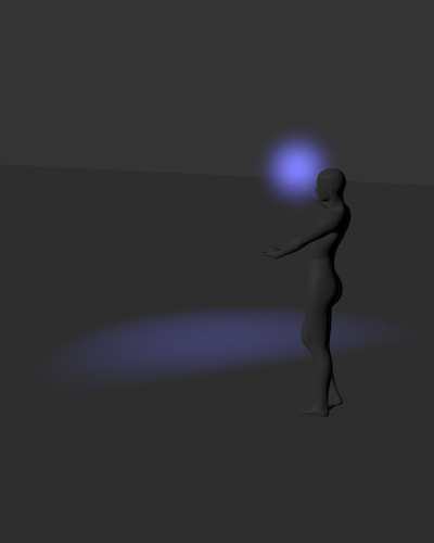

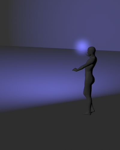

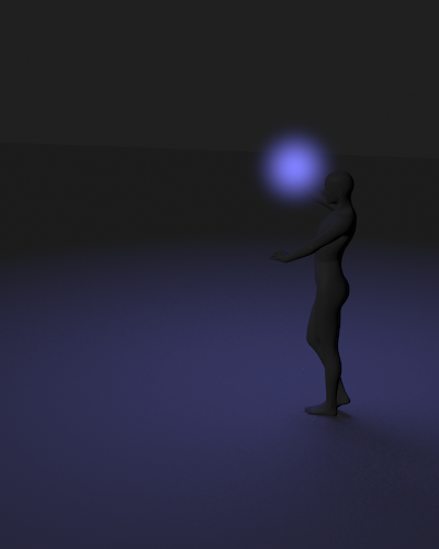

    Falloff makes a huge difference in the control of the light...
    Added a glow shader to the sphere, parented it to Genesis' hand (parented the plane to the sphere) and played with the falloff to get the effect I want.
    Pete, I keep forgetting about the GeoEditor...but yeah, that would work. We've had it for years now, and I still keep forgetting about it. I swear, half the time my brain is stuck in DS3.
    Second image is a much smaller falloff distance.
    400 x 500 - 167K
    400 x 500 - 166K
    Post edited by mjc1016 on

    And here's one putting a geometry shell on the sphere and attaching the UberArea Light to that, instead of using a plane.

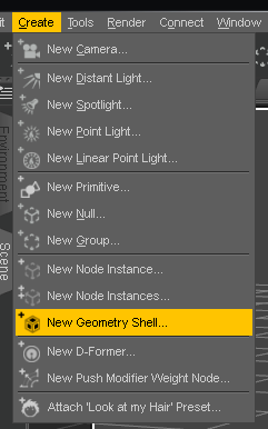

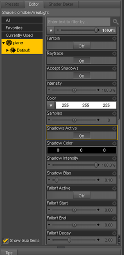

    To create a geometry shell, select the item in the scene tab and then go up to the Create menu, then scroll down to the Geometry shell and click on it. A new item, parented to the original will be created, in the scene. It has its own entry in Surfaces, so you can now alter them separately from the original. First image.
    For the falloff settings...in the surface tab, on the surface you've applied the light to....second image.
    332 x 681 - 23K
    241 x 386 - 15K

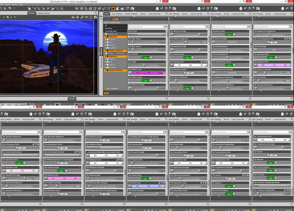

    I don't see some of the settings you're showing me. :(
    Here's mine:
    2000 x 1436 - 553K

    The shell is just that, a copy of the surface of the item, slightly offset. This allows you to add additional features to a surface...like glowing lights. It's a quick way to add layered effects, without the complexity of a mult-layer surface shader.
    Since you have the surfaces with all the shaders already set, you can safely add the UberArea Light to the 'windows' of the shell without altering the surface of the actual model. Create the shell, then select the window surface and apply the light shader. Then turn the Opacity on all surfaces of the shell to 0%. Then for the window surfaces, change the light color...it will be near the falloff settings...down near the bottom of the list...to the purple of the window. That will be the light color. Lower down the list, you'll find the falloff settings...about 1000 to 1500 should be enough for the end distance. The start is fine at 0.
    The falloff is what is going to control the amount of glow you get in the rest of the scene. It's a distance determined/dependent dimmer switch.
    One of the problems you are running up against is the fact that the Studio surface shader and the version of 3Delight it was written for did not have a true emissive glow capability. Yes, you could have an area light (light emitting surface...but it didn't glow). You could 'fake' it to some degree with the ambient channel or specially written 'glow' shaders...but neither method actually casts light. So you need to combine a light shader and a 'glow' shader to get the effect you are after. Now, 3Delight IS capable of true emissive surfaces...except they require new surface shaders, that aren't in Studio (yet).

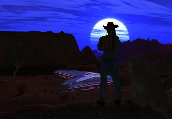

    This is what it's looking like so far, with the shells ...
    722 x 500 - 175K
    Looking better. If you want a bit more light from it, increase the falloff max distance and/or the intensity.
