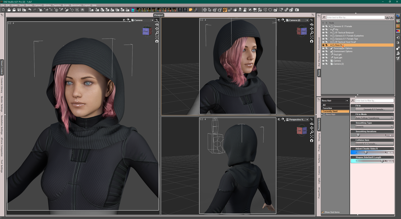

  • crosswindcrosswind Posts: 9,747
    edited February 2023
    Making a natural fit, easy or not, depend on the morphs along with the products you use and a couple of proper tools. For most of the cases, I just dial in the morphs of the hat/hood/hair and use Mesh Grabber to make them well match from one another.
    Sickleyield's hair helper is a good product but it cannot handle all the cases. Especially some of its morphs will drag the hair into the head and it will looks worse. Just because the hair fits on the helper, the collision in between the hair and the figure's head will be a problem. You have to do lots of tweaks. You may well judge the products then decide what tool you're gonna use. For dForce hair, you may also take a look at https://www.daz3d.com/dforce-hair-helper-and-knitted-hat
    For this Rera Hair, a non-dforce one, I just roughly dialed some morphs of the hair and hood, gave them a couple of drags by using Mesh Grabber. (sometimes you need to grab and drag both of them) The hair could be well 'wrapped' into the hood. If some fine and messy hair are not easy to be selected, you may use Geometry editor to select them, even hide them.
    Beside, Mesh Grabber can save the 'dragged result' as a morph, you may reuse the morphs to fit the hair to other hats/hoods by dialing different percentage. That'll save some time~

  • foxyfoxfurriesfoxyfoxfurries Posts: 391
    Seems cool! I will try it out! Really thanks for the pictures and guid it will help me when I will buy it! Thanks it will help me for sure!!! :)
