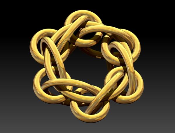

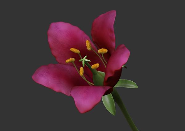

  • Cris PalominoCris Palomino Posts: 12,986
    The DVD is quite good. Madeleine is a well known ZBrush artist. She explains quite clearly while showing examples.
    The new features in ZBrush are quite awesome if you take the time to learn them. ZModeler basically is the next evolutionary step for ZSpheres, Nano mesh is the next for Fiber and Micro mesh, and Array is just a very cool way of working, once you wrap your head around it.
    This is my flower which started with ZModerler, uses Array for all petal like structures plus the filaments and anthers. The pollen on the anthers is done with nano mesh.
    The chainmaille jewel is done with array.

    Must admit I love the new features I've tried mainly the zmodeller brush but love what you've done with the flower and the jewel!
  • NovicaNovica Posts: 23,925
    Beautiful- love the flower! :)
    edited April 2015
    This is a tutorial I did on making the Chainmaille Jewel.
    And thank you both for your kind words. :)

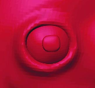

    I'm back, starting over with Zbrush and experimenting. (In a rather big way.) While there's easier ways of doing this (and experienced users feel free to suggest it, please!) this is how I am managing to at least get things done. I'm using the Introducing Zbrush book by Eric Keller but also going "off on my own."  This is how to do an eye for a character.  If you have a different way, please feel free to share. And I'll be adding a link to this post to the beginning of the thread for easy reference.
    Creating An Eye
    These are the brushes/intensities to get it done easily- this is the Z Intensity / Focal Shift / Brush Size
    SPOLISH for the eye hole-  31 /-39 / - 52  (makes a decent round indentation for you.)
    Then PINCH to firm the rim  16 /2 /32
    CLAY BUILDUP to add back to the rim  24 / -15 / 19  (BTW, this is a PERFECT setting for claybuildup. Not too big or small.)
    Then SMOOTH it. 11 / 26 / 19
    Use MOVE TOPOLOGICAL to round the rim, get what you want.  28 / 14 / 62
    Make sure Dynamesh is on in Geometry. (if it won't go on make sure remove lower subdivisions is done and up the subdivisions) THE INSERTS WON'T WORK IF IT ISN'T ON. Dynamesh merges your figure and the inserted item.
    B-I-W  (Brush flyout, I for insert brushes, W for INSERT SPHERE) Drag and create sphere, release. Everything else will get masked.
    Move your sphere and do whatever you want to shape it. I used:
    Move Topological  28 / 24 / 46  and then fine tune with NUDGE   49 / 11 /46
    Then Smooth to flatten. When done, hold CTRL and drag out in viewport (NOT ON FIGURE) to clear the mask.  Rinse and repeat to put a smaller circle on the sphere you just created, for a pupil or even a highlight for the eye.
    TIP: One thing to keep in mind, whenever you CTRL+Drag in viewport to do Dynamesh, or when you Smooth, your mesh tightens/shrinks. So I do things a bit larger than what I need, to accomodate that. For instance, I may or may not keep this outer rim this tall.
