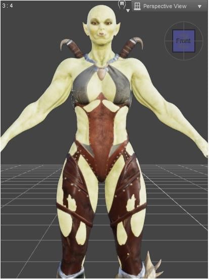

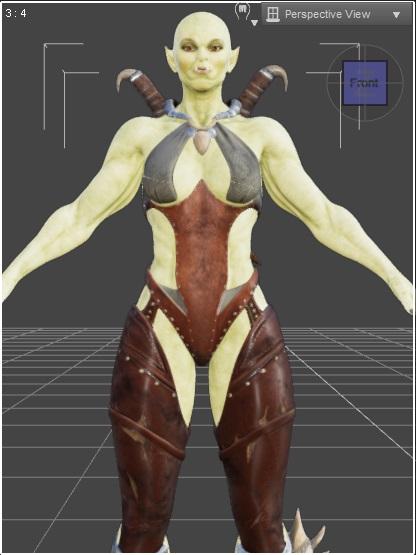

Clothing not fitting after morph
Hi, I'm still pretty new.  So I know about AutoFit for when a clothing item was designed for a different figure than the one you're using (Genesis 2, 3 etc), and I know how to get the AutoFit pane to appear in that scenario when it doesn't come up automatically.  But what about when the outfit was designed for the correct base figure, but it still doesn't fit right after modifying the figure?  Manually calling the AutoFit dialog doesn't seem to do anything in this situation, presumably because the intended base figure isn't changing.  Is there anything that can be done about this?
Specifically, I'm trying to use this outfit with the RawArt She Orc figure.  Both were designed for G8F, but the outfit has a lot of spots where it goes inside the body.  The figure I actually want to use has some further modifications to it which casue a few more holes to open up and also makes the lower legs not fit, but a lot of the problems, mainly on the upper legs, are present if I simply load the SheOrc character and apply the outfit to it.
Scaling the outfit up doesn't help.  By the time I've increased the scale enough to get the holes on the upper legs to disappear, a noticable gap has been created around the chest, and for the futherly modified figure increasing the scale makes the lower legs even worse.
I've attached two images so you can see what I'm talking about; one with the outfit loaded onto the SheOrc figure without further modifications, and one with the outfit scaled up a bit so you can get an idea of what it's supposed to look like.
Can I do something about this, or do some outfits just not work if you modify the body too much?  Thanks.

     I hope that outfit is actually more than one piece. {I don't own either the character or this clothing set}
    Yes, it should be able to be made to fit but it will require a little work, called morphs. In Notepad, copy/paste the names of whichever generated morphs are made by D/S into the clothing when the character morph was dialed into the figure.
    If the clothing can be loaded one piece at a time, work with one piece at a time - whether you use Hexagon, or dFormers, or other means - make the one item to look correct, target figure AND clothing piece to be at BASE Resolution, no geografts attached.
    Export out the clothing piece that fits as .obj. Then in D/S remove it from the scene and load in a fresh one. Select that clothing piece.
    Using Morph loader pro, bring back in that morphed .obj and make the morph in the clothing -- call it the same as the generated morph was called. If it looks okay, zero the morph and save it REVERSING deformations {so we don't save the character shape in it}. Once it is saved, then remove it from the scene and load in a fresh one. It will now [hopefully] look like it is supposed to.
    {To get beyond the generated morphs which D/S will keep creating - Parameters Tab in Edit mode - rename the generated morphs to something you will recognize as what not to save. I use the term "delete this" on both the name and the label. D/S will not make 2 morphs with the same name on the same item.}

    The outfit has multiple pieces, but what you're looking at is just one piece, the main one.
    I thought a "morph" was a slider that changes the shape of something, like a Face Transfer slider or "Arms Length," "Nose Size" etc.  What are you actually referring to?
    If you mean something analogous the the sliders I mentioned above for a figure, then I have two questions about this.  One, I don't know how to see that for a clothing item.  And two, if whatever you're talking about can also be used to see what body modifications have been made to a figure when using a preset without having to check each one manually, then I would definitely like to know how to do that.
    If you're talking about something else, then again I don't know what you mean.
    Apart from the fact that what I showed above isn't multiple pieces, I have no idea how to do what you just said; and if I did, I probably wouldn't have asked the question in the manner that I did.  I said that the only things I knew to do about this were AutoFit and adjusting the scale (and now, what lorraineopua said).  You said "make the item look correct"; and that would be great, but how?

  • You might find this product helpful: https://www.daz3d.com/sy-clothing-breast-helper-genesis-8-female
    I have no idea if it will work with exposed flesh.

     That product has just about solved the problem with the Retaliation armor top, thanks very much! yes
